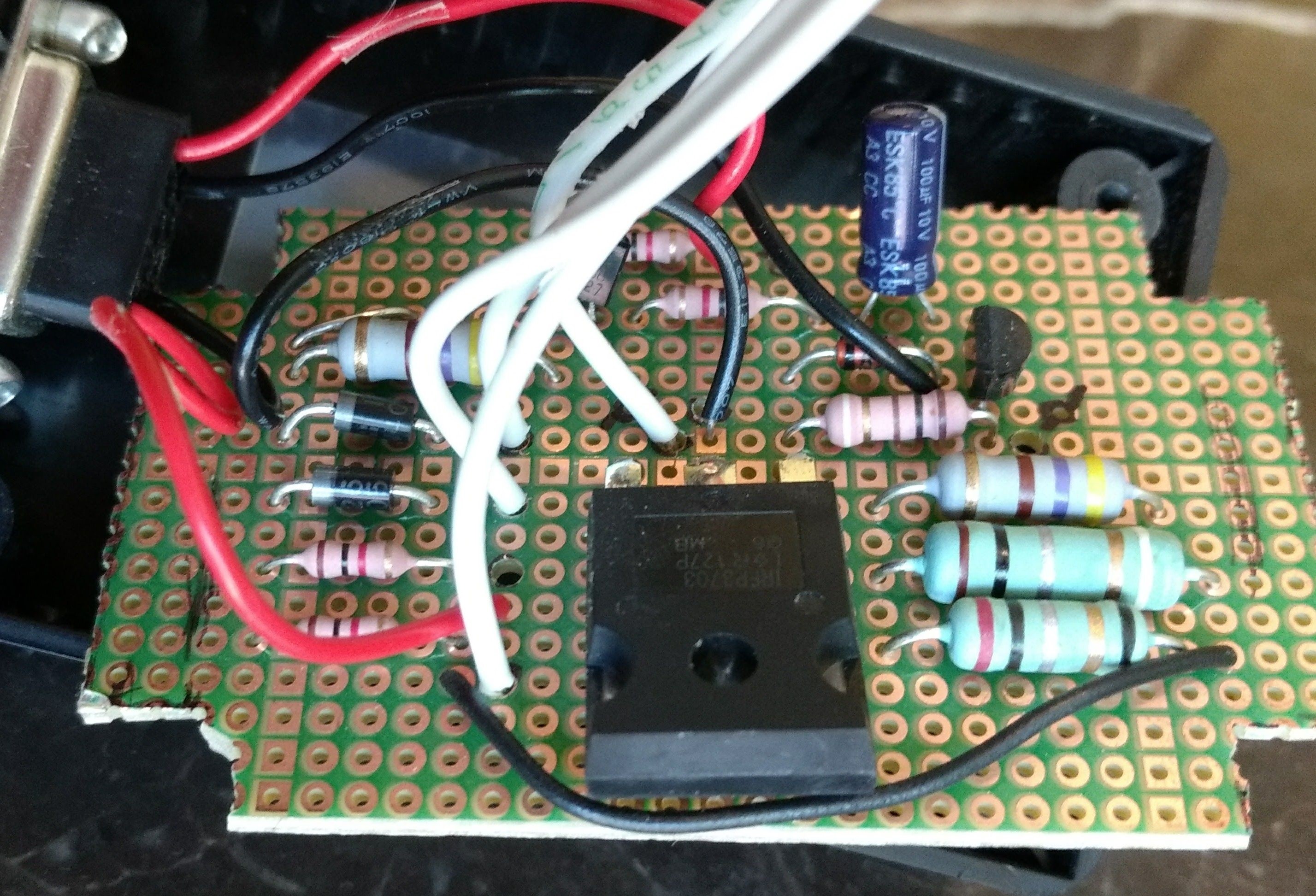

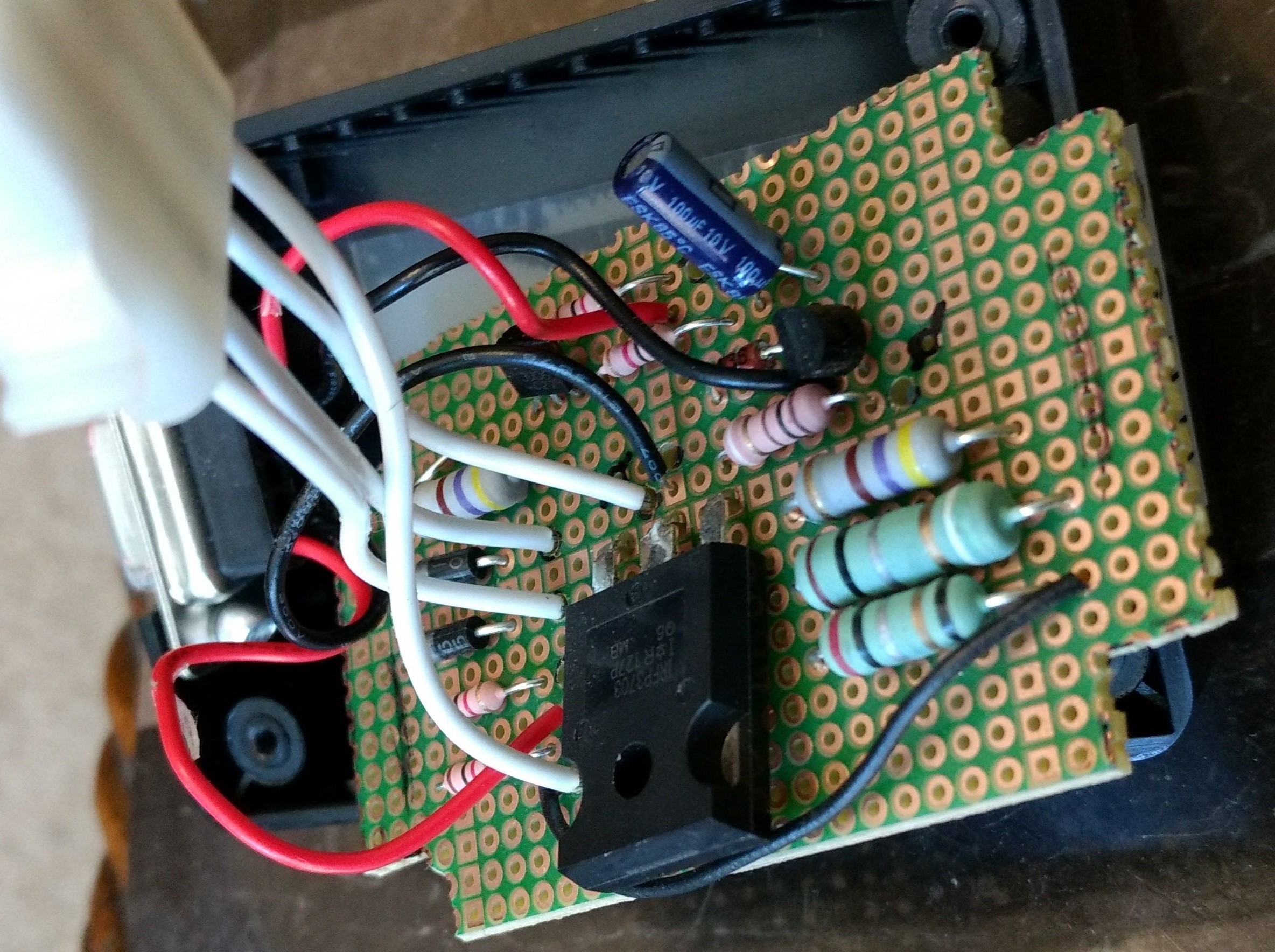

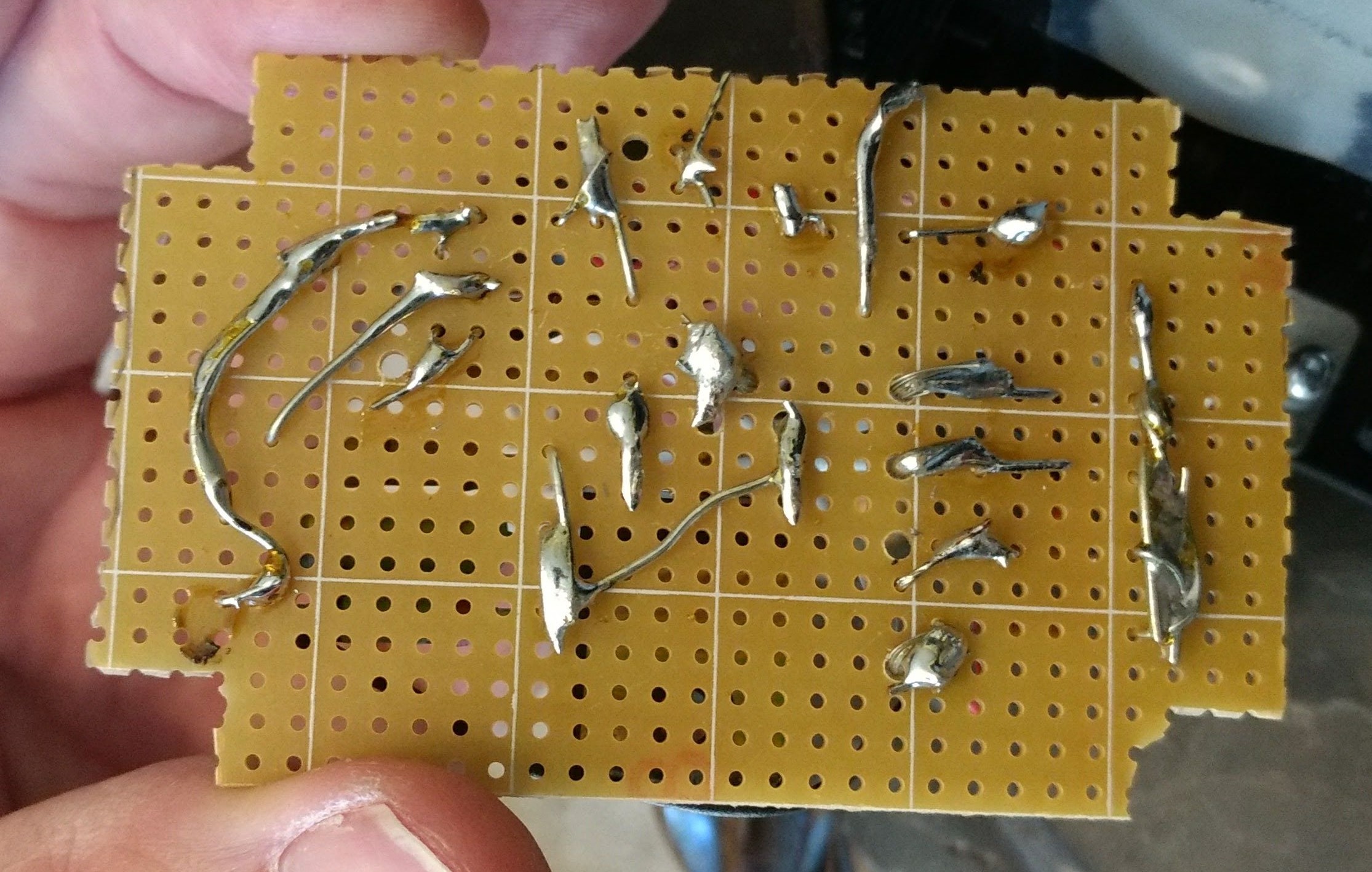

How is the circuit constructed? Can you post
some pix?

PostPosted: Wed May 17, 2017 8:34 am    Post subject: Re: IVO Prop current limiter Reply with quote
Pictures attached...

At 11:34 AM 5/17/2017, you wrote:
--> AeroElectric-List message posted by: "kfav8r" <kfav8r(at)outlook.com>
Okay, I think I know what your problem
might be. The LEDS in the design are
not mounted on the board and leadwires
out to panel mounted LEDS are subject
to noise ingress and premature tripping
of the stall limiter.
Just for grins, try mounting some
LEDS right on the board and remove the
long lead wires.

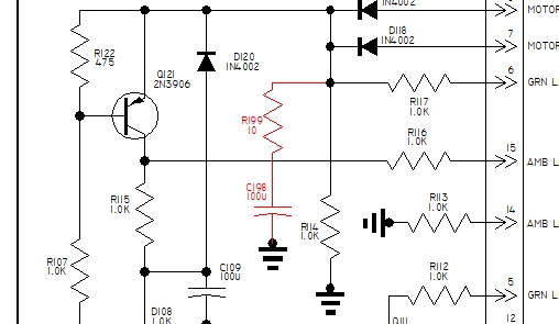

[img]cid:.0[/img]
Doug,
Try tacking this combination of components onto
your assembly. The experiment is to see if adding
a smoothing capacitor to the circuit's power
source will sufficiently attenuate the antagonistic
energies. The 100 uF cap is the 'smoother' while
the 10 ohm resistor mitigates inrush currents impressed
on the circuit when the directional control switch
closes . . .
