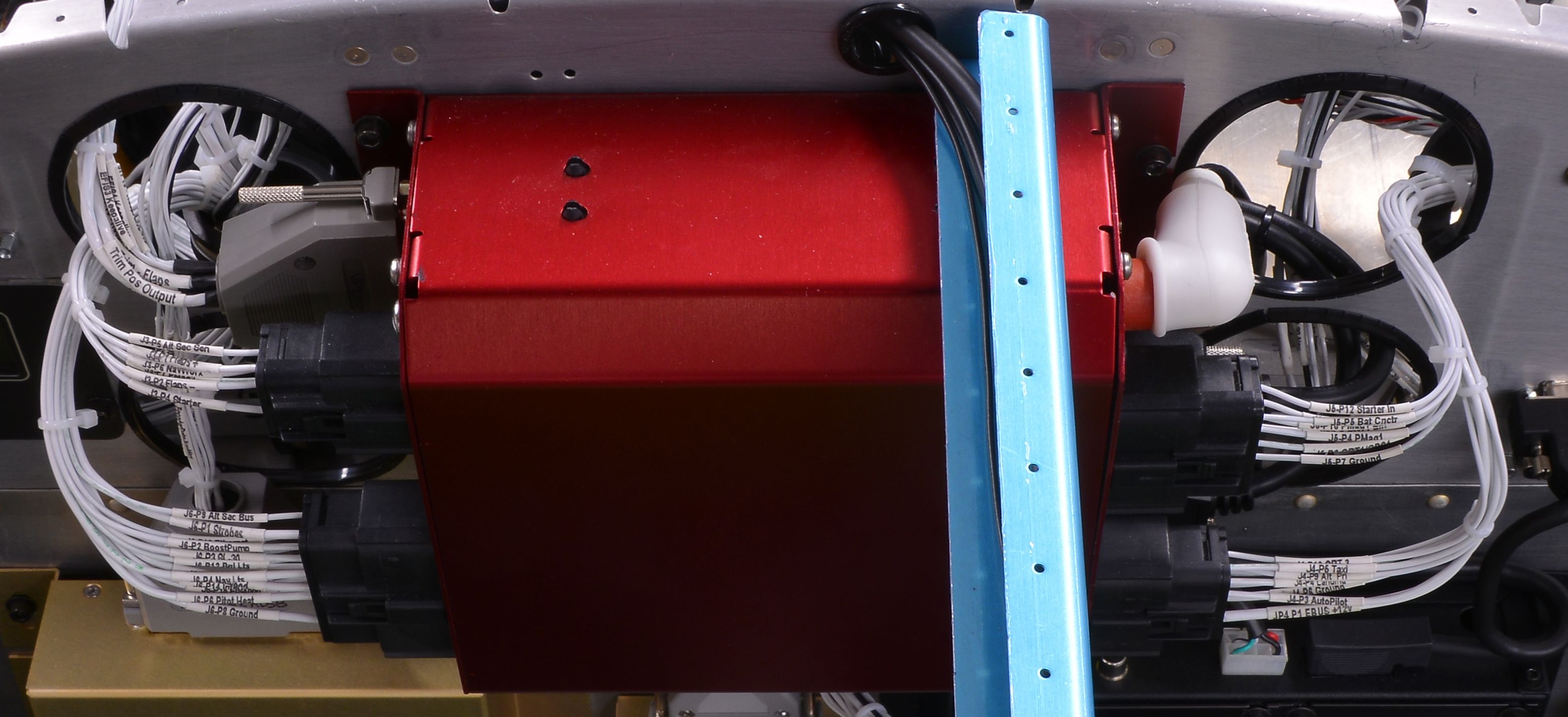

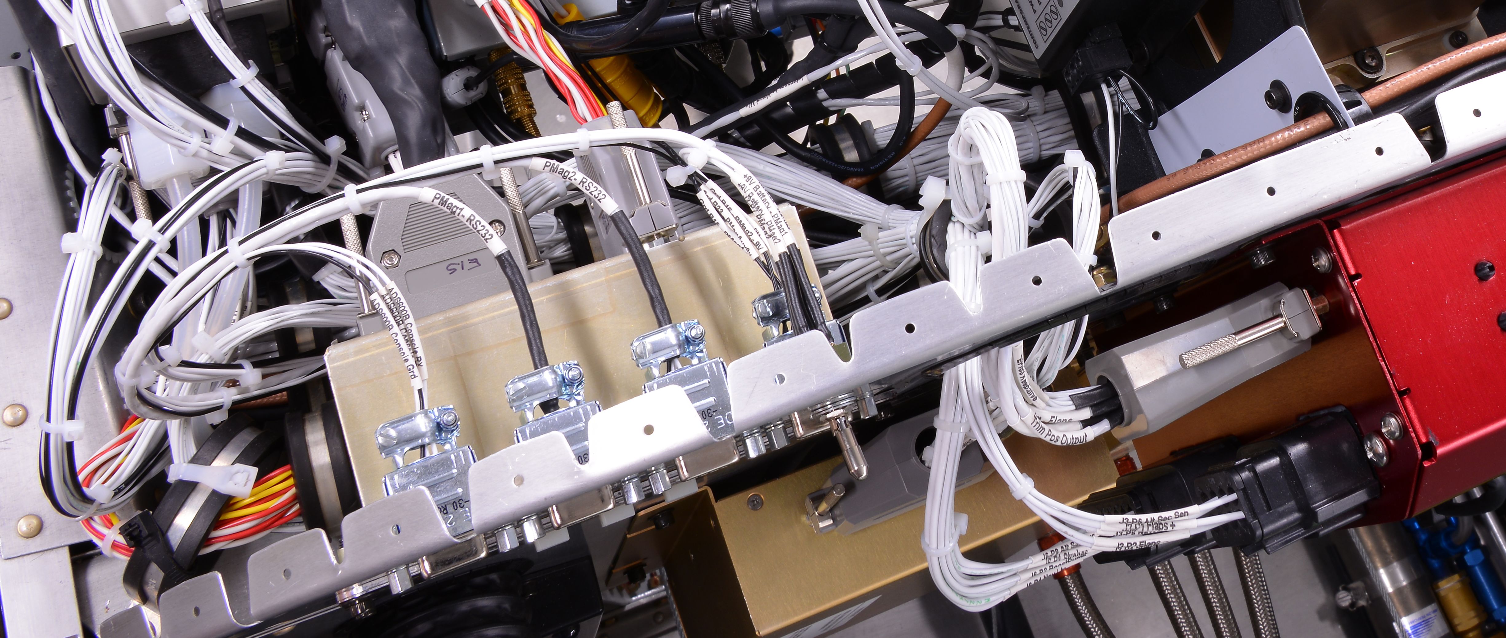

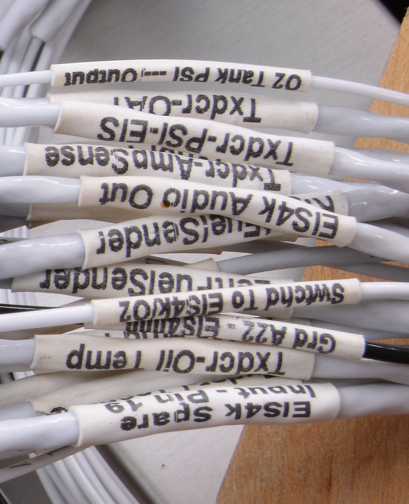

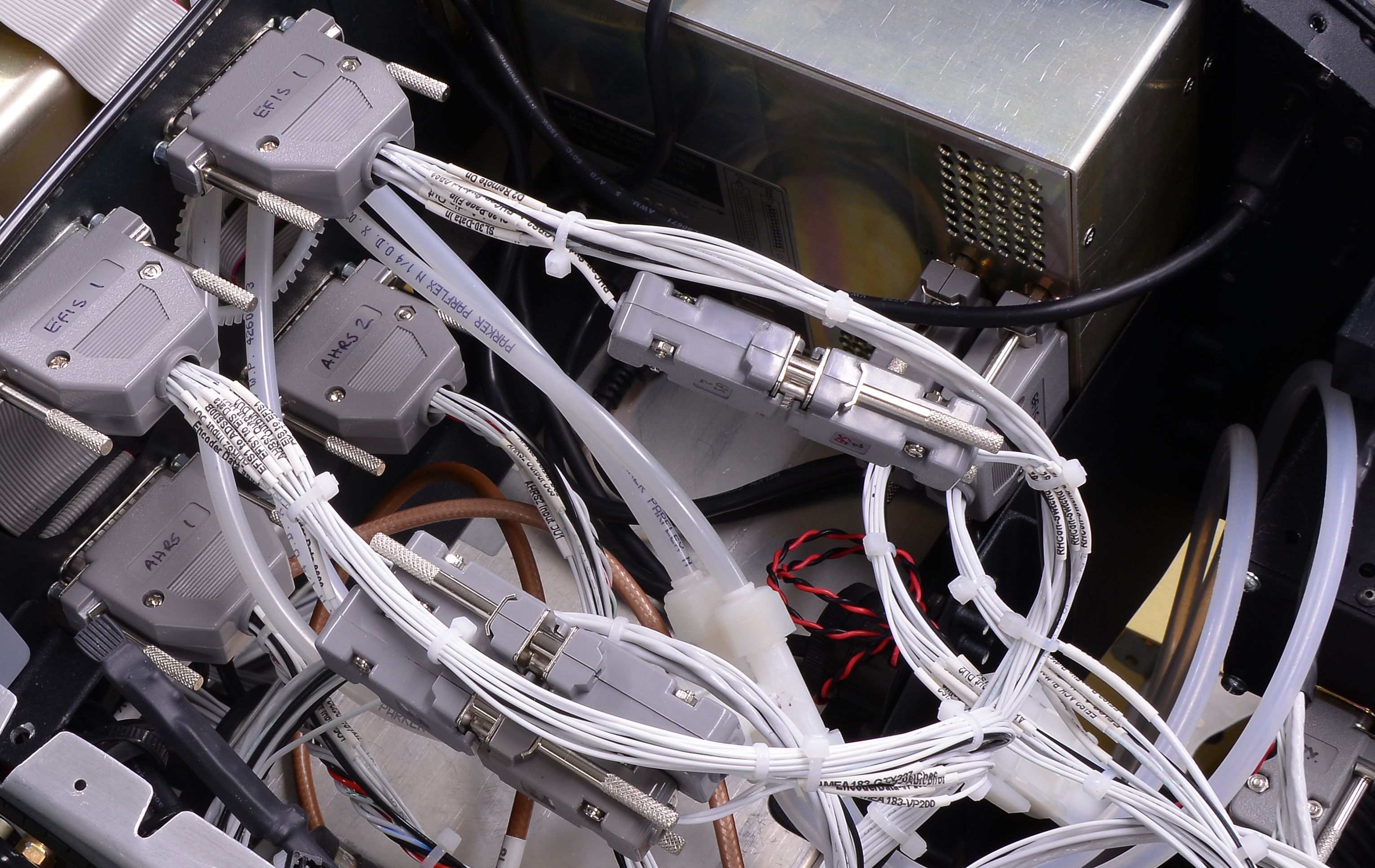

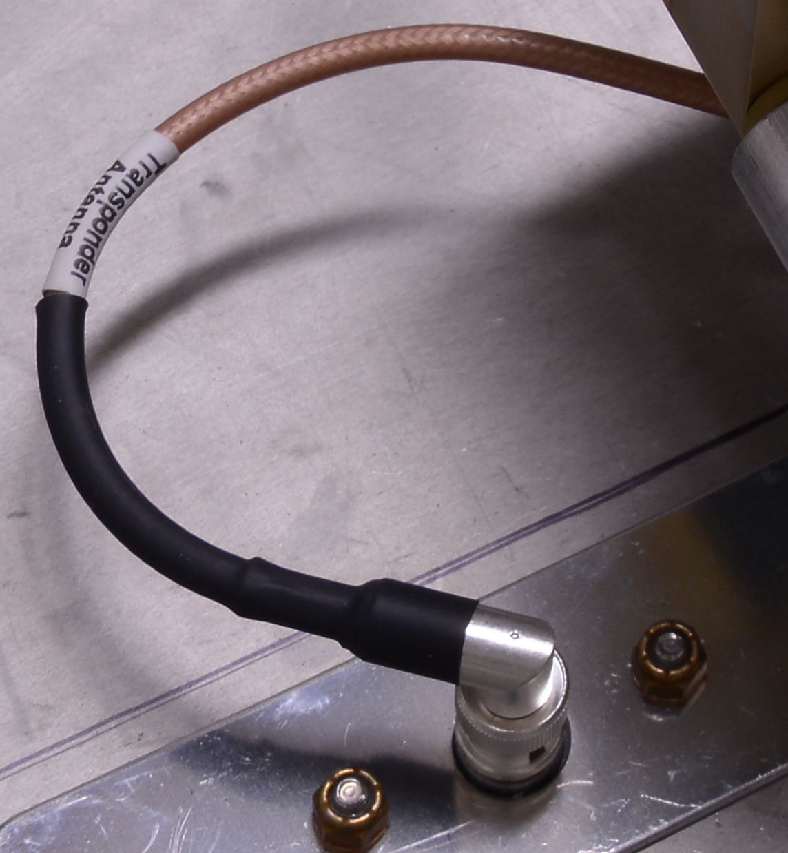

PostPosted: Wed Dec 18, 2013 9:59 am    Post subject: Wire labels Reply with quote
At 10:40 PM 12/17/2013 Tuesday, you wrote:
Anyone out there have a good system or product for labeling wires. I'm starting to lose track of which goes where...

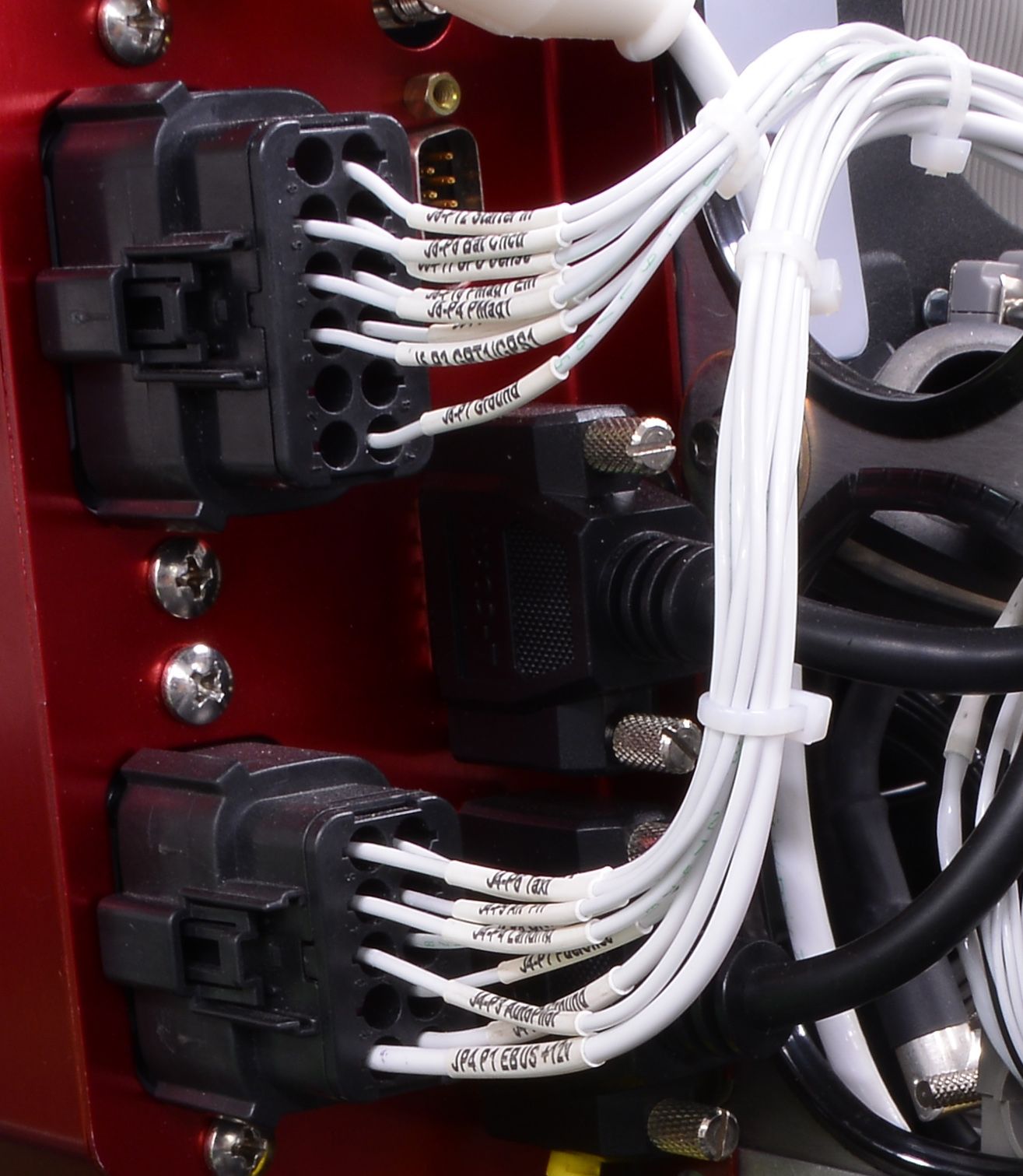

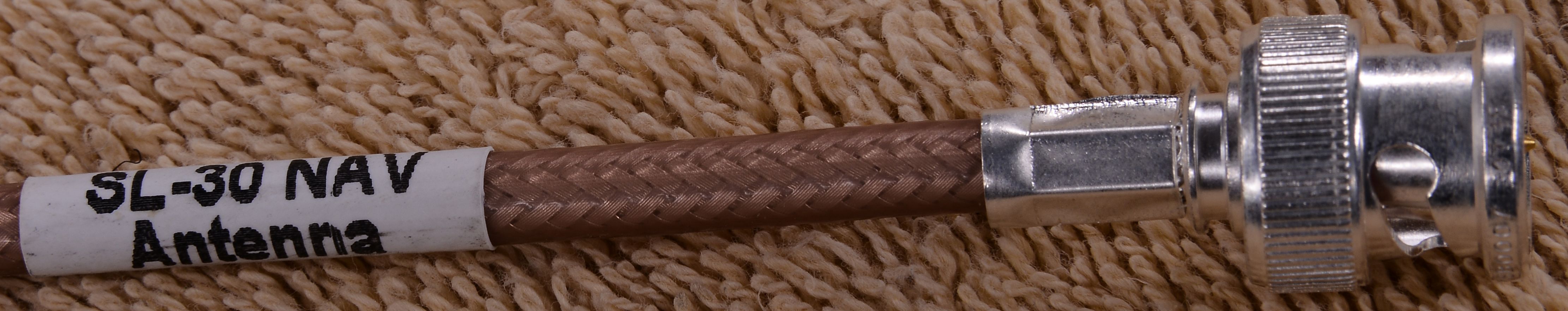

I use this product and love it:
<http://www.mattsrv8.com/users/display_log.php?user=MattsRV8&project=2273&category=9044&log=173811&row=1>http://www.mattsrv8.com/users/display_log.php?user=MattsRV8&project=2273&category=9044&log=173811&row=1
Attached are a few samples of what they look like in action.
Matt

Matt Dralle

PostPosted: Wed Dec 18, 2013 10:27 am    Post subject: Re: Wire labels Reply with quote
Matt:
Your labels look great but you didn't mention what you use to do them...

PostPosted: Thu Dec 19, 2013 9:17 am    Post subject: Wire labels Reply with quote
Check out this web page from my RV-8 building site. All the det's are there:
