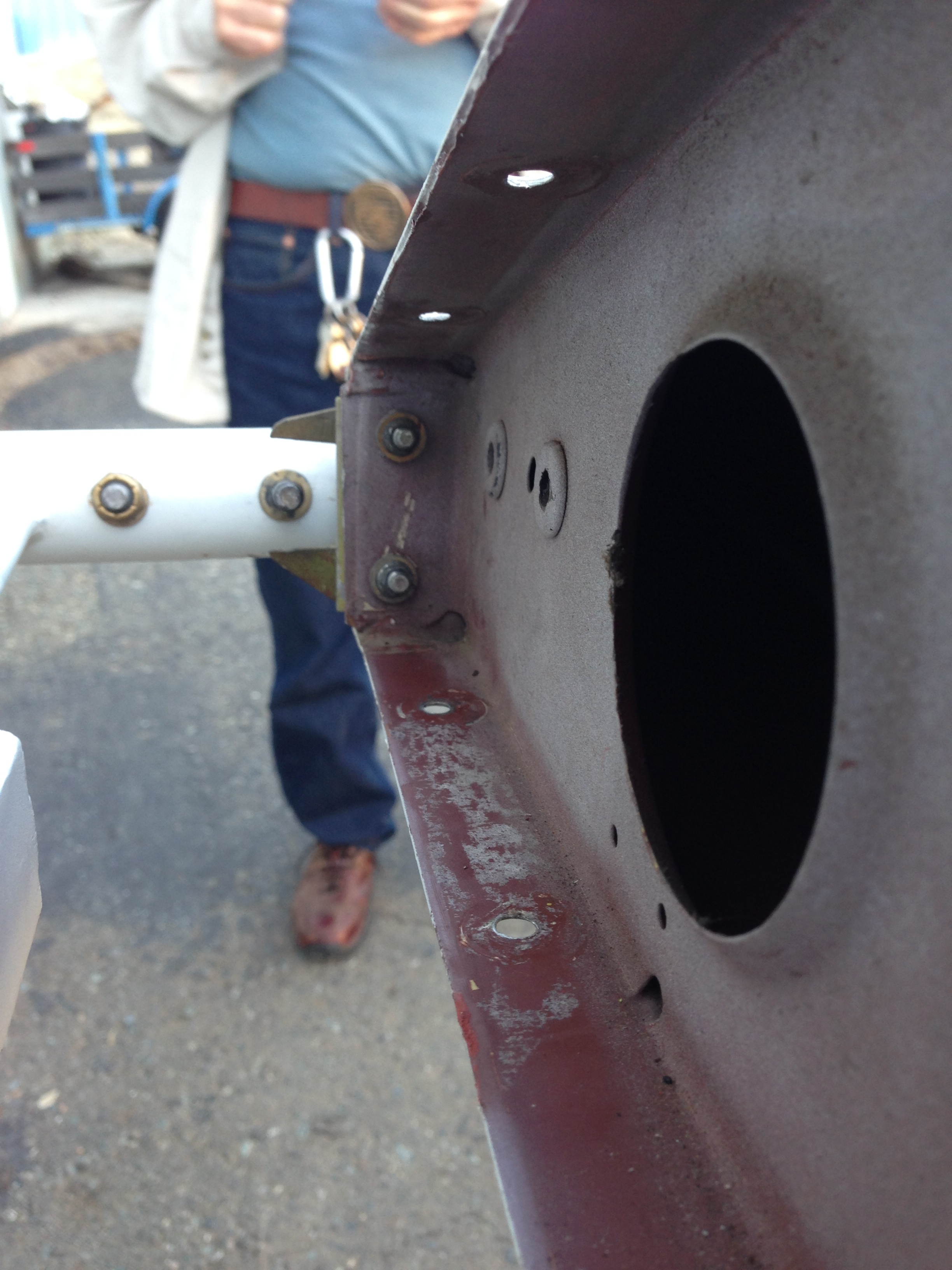

Customer came in with a broken aileron bracket. I did the annual almost 2 years ago. Someone else did it last year.
Apparently, the bracket had been broken before and someone glued it back together with contact cement.
When installing the new bracket I noticed the holes drilled obviously wrong. Could explain the problem all along.
