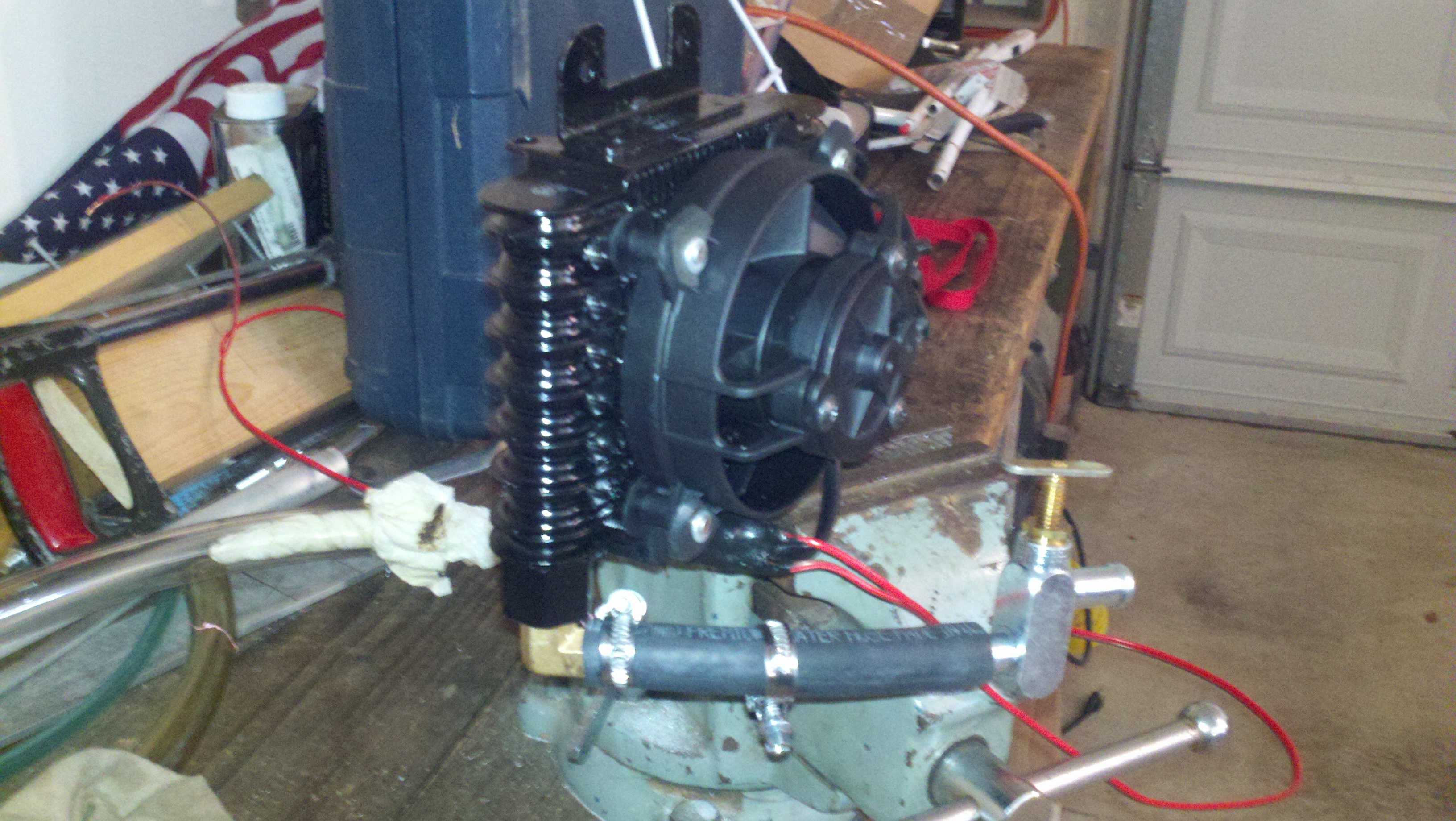

Plumb a motorcycle radiator inside your cockpit with a 12 volt fan on it.

I'm liking the clothing suggestions a lot better than my cockpit radiator idea,
like someone said, it's a crap pile of work to reengineer the cooling system
to that degree.

PostPosted: Sat Dec 28, 2013 6:55 am    Post subject: Re: Keeping warm Reply with quote
I used a small oil cooler with the SPAL fan that moves lots of air. Plenty of heat and simple to mount and only added 2# to the airplane. The small one 4x6 worked for me. Test here is weird but the 4x6 with fan. don't try those small computer fans, they doon't move near enough air unless you are extremely air tight cabin. This fan moves tons of air, that is the key. Just be sure to tap into the radiator hoses before the thermostat. If the 670 has built in Thermostat you could remove it and use the Thermo-Bob one.
http://www.circletracksupply.com/northern-hurricane-oil-or-transmission-cooler-with-fan.html
I have to throttle back the water flow to keep from being roasted out.
Dennis

PostPosted: Sun Dec 29, 2013 9:15 pm    Post subject: Re: Keeping warm Reply with quote
more, great ideas, thanks!
Dennis, thanks for taking the time to post and show your installation--looks like a solid, bulletproof design, simple and reliable, I bet.
this deserves consideration and thanks for the recommendation on the fan--as I think about it, it makes total sense that volume of air moved would be the difference between success and failure
thanks man!
