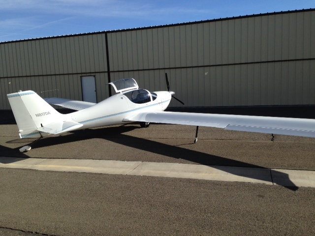

The Phoenix has risen from the ashes. Test flight this morning went very well. No issues and no significant changes.
I was able to pull 3.1 Gs. That is quite a bit of pull. This was both in a wind-up turn and a straight ahead pull. I didn't feel the need to go beyond that level. Its quite a dramatic maneuver. Stall characteristics normal. Trim settings unchanged from pre mod 78.
It took a few days less than 3 months to complete this. Too many hours to fathom. I hope there are no more such modification to come in the future. Anything else down the road should seem like a walk in the park compared to this.
I still officially like the change of bolts to flush screws on the CS08 brackets. Piece of mind.
Thanks to Neville and Bud for all their invaluable help.
Dave
A227
Mini U2 - 30 more minutes of flight time than 3 months ago!

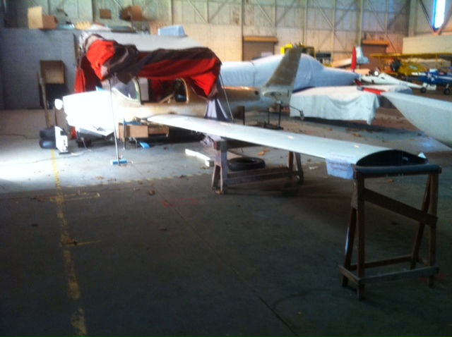

[img]cid:ii_1434481ff5b94612[/img]I am so pleased Dave is flying. I set myself a task,over the Christmas holidays, of fitting my newly modified (Mod 7Cool wings on the fuselage for the first time.
Bushes bonded in and cured I moved on swiftly to align the wings only to find the Port wing seeming to be 1" further forward at the reference point than the Starboard wing. This means that the gap for the new front right mount will not even take the mount let alone the layups, the rear right gap is correspondingly too much. The right wing sits really well both bush gaps as expected.
I have tied the wings forward to ensure no rearwards movement of the spars.
I have had my remote camera in to cross check.
I have a grave fear that my port spar has sagged but cannot work out how.
I suppose a shim on the port spar inner bush front face will cure this, can any one think of something else, I have rigged and de rigged 4 times with different helpers.
Alan Twigg
kit 463 and full of dread.

PostPosted: Tue Dec 31, 2013 12:59 am    Post subject: Mod 7 flight ready Reply with quote
Hi Alan,
Sounds like the cockpit module might be a touch skewed, doesn't need to be much to throw the wing rigging out.
Easy fix [ done it before] is a shim on the rear face of the seat back, thin piece of steel Reduxed on, clamp it up with a straight edge across the width of the module, so the port spar sits square up to it. Put a couple of CSK rivets in as well, so it can't get knocked off when rigging and fall into the bowels.
This will true out any skew, shim won't need to be much as when the port tip moves aft, the stb tip will move fwd the same amount. A 1/2'' large area washer might even do it ?
This will open the gap between the port lift pin / fuselage, and close the drag pin gap.

PostPosted: Wed Jan 01, 2014 8:55 am    Post subject: Mod 7 flight ready Reply with quote
Thanks Nev, I was thinking along those lines as the wing definately needs to move reawards at the tip, this could solve both issues
Alan
