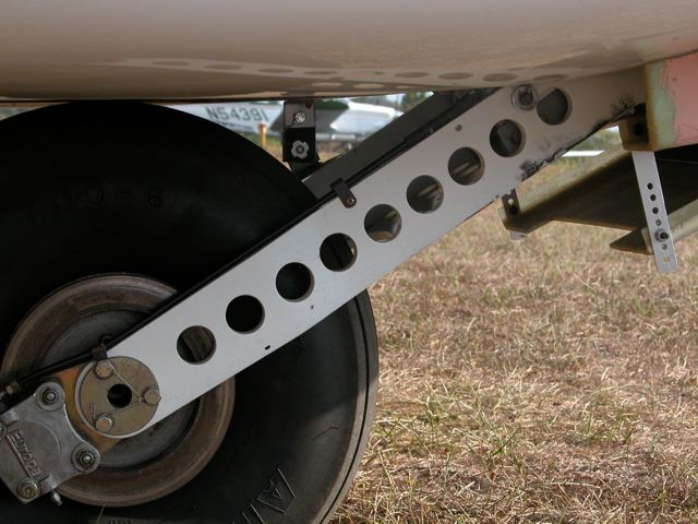

I did this using my mates Bridgeport Mill and it took about 700 grams out.

on the subject of weight savings, I can't help but notice how heavy the mono swingarm is. I noticed in Germany one builder had put many lightening holes in it (among many other mods). I had also wondered if indeed it was over-designed and could use some strategically placed holes. Is that the only builder who has lightened it? Has anyone done any math on that heavy piece?
Pete...here's a pix of Paul McCallister's swingarm...Fred
[img]cid:C6E4B40D-0F4F-42DB-BF1E-8F885C09842B[/img]
