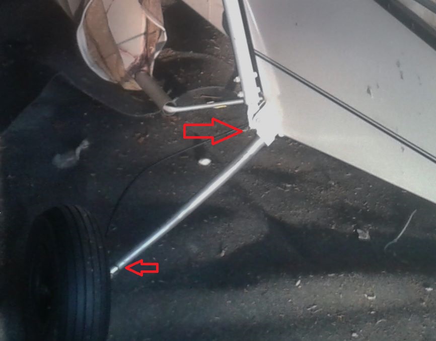

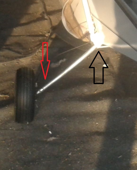

How do I replace the main landing gear?
I unscrewed the bolt near the hub and the bolt inside the fuselage, but not sfilla the bar of aluminum.
Why?
how can I do?
I enclose a photo

Try applying penetrating oil through the bolt holes inside the fuselage. It seems your gear legs are corroded to the steel sockets. Also apply some around the gear legs where they protrude from the steel sockets.
Raise the fuselage and put a steel rod or a screwdriver through the lower bolt hole that holds the axle socket to the gear leg and twist and pull from there. You may want to try tapping down on the steel rod or screwdriver with a hammer also.
Make sure you grease your new gear legs before assembly to avoid this in the future.
