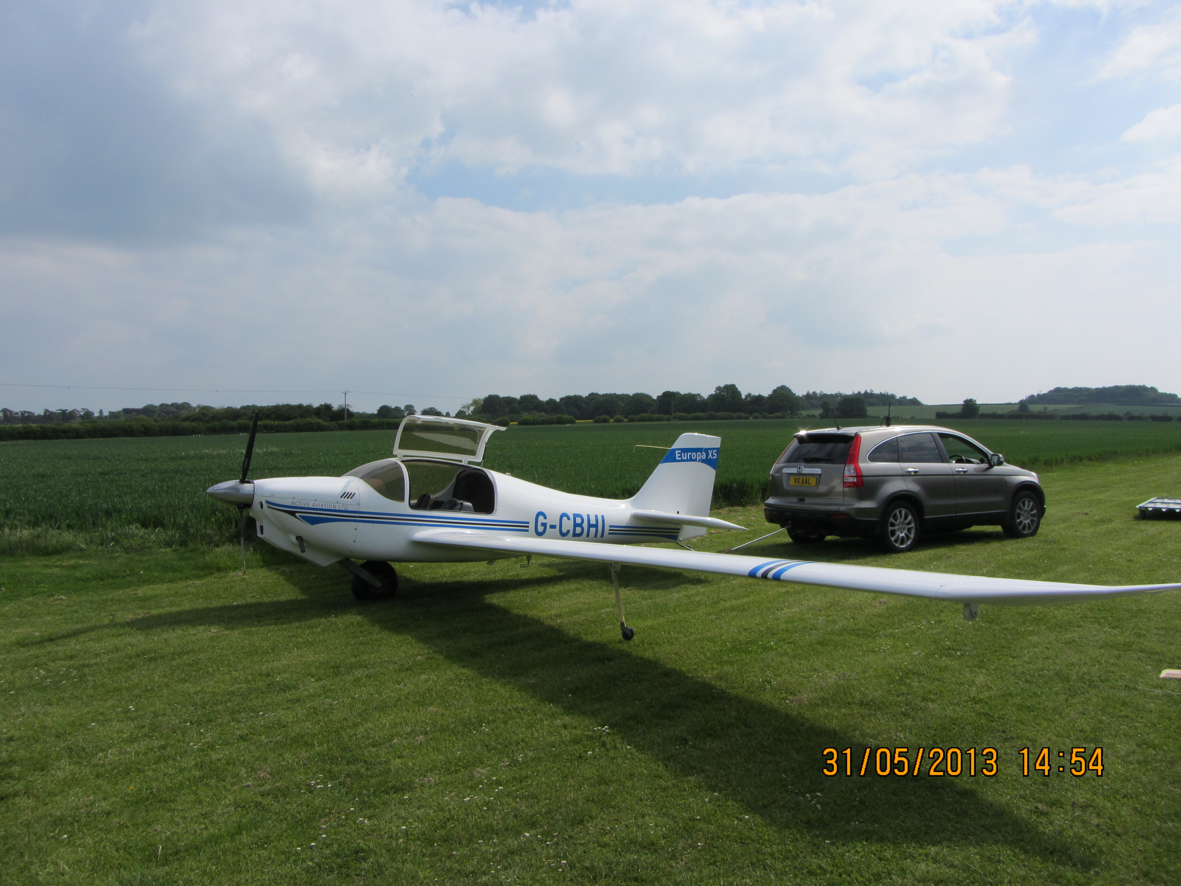

Making great progress after a delay over Christmas. Drag pin spacers fitted and glassed; Lift and Drag fittings going on in next two days then off to the paintshop.
Having a gliding instructor job, I have so much spare time with all this wind and rain in the UK, I must be one of the few with anything positive to come out of it.
The poor souls in Somerset are flooded out, the South Coast rail line to Cornwall is washed away and still it comes. No sign of help from the military.

PostPosted: Thu Feb 06, 2014 2:23 pm    Post subject: Motorglider wings Reply with quote
Ian, I wonder whether a SmartASS would possibly be
considered as an acceptable stall warner. It is in my
experience a considerably more effective tool than the
Europa stall warner, (having flown with both now for a
couple of years), and much easier to fit. It has in
addition a wheels up warning which sounds if you slow to
approach speed without putting gear down. It is currently
out of production (at Smart Avionics) but Mark Burton is
hoping to launch a new improved version in the next few
months.
Regards, David Joyce, G-XSDJ

PostPosted: Thu Feb 06, 2014 2:38 pm    Post subject: Motorglider wings Reply with quote
David,
Not sure how SmartASS is installed, is it tee'd into the ASI?
Trouble with the ASI is it tells you what has happened anything up to 20 seconds after
the cause of the event (loss of speed) occured.
The stall warner gives you an instant warning of change of AoA, and that's what matters.
By the time the ASI has told you you're stalling, you already have.
AoA tells you it's going to happen if you don't do something quickly, (get the nose down).
Graham

PostPosted: Thu Feb 06, 2014 3:19 pm    Post subject: Motorglider wings Reply with quote
Graham, It is teed into the pitot and static airlines but
calculates speed electronically and has built in
accelerometers so that it compensates for g and
effectively gives Angle of Attack related warnings. It has
two modes with a female voice through your headset:
firstly it/she will just tell you your airspeed at
intervals (I rarely use that mode) but more importantly it
acts as a speed director in approach or take off mode.
Once settled on your approach you press a button for a
couple of seconds and she says Chosen speed is 60kts (or
whatever). Then if you stay within a few percent of that
she says 'Speed good' in a calm voice at intervals. As you
slow down she has three messages in progressively less
calm voice: 'Speed slow', 'Speed very slow'; and Speed
very slow preceded by a loud gong. Quite impossible to
ignore. Speeding up going away from the circuit she goes
to sleep but wakes up automatically when you get within a
few percent of your previously chosen approach speed,
which remains set unless you change it. It is a brilliant
piece of kit, designed as a life saving tool for
emergencies like EFATOs when the most experienced pilots
will still sometimes find themselves ignoring speed
control and falling out of the sky. But quite
coincidentally it is very much more effective than any
stall warner I have flown with. My Europa one doesn't make
much noise - a problem for a deaf old fart with expensive
modern headset, and on top of that it sounds for an
appreciable part of take off and landing runs, so I am
'trained' to ignore it!
Regards, David

PostPosted: Thu Feb 06, 2014 4:44 pm    Post subject: Motorglider wings Reply with quote
David
certainly sounds very cleverly designed. I agree with your point about stall warner being too
ready to cry wolf. My preference would be proper AoA display with voice warning. Then you have no time delay
between event (AoA change) and warning.

alan.twigg775(at)gmail.co
PostPosted: Fri Feb 07, 2014 12:06 am    Post subject: Motorglider wings Reply with quote
Thanks Ian, moats interesting.
I have fitted the Europa supplied Stall Warner.
I have fitted an undercarriage up Warner but was thinking of including an air switch but since the Duo simply has a horn if at brakes are open with undercarriage up, I will do the same on the Europa.
I have installed a pulley under the Airbrake torque tube to clear the Rudder Cable.

It might be useful, as you work with LAA, to have a US FAA approved example of how to handle the issue of Motorglider or Airplane.
Our Airworthiness Certificate states "Amateur Built Aircraft/Motor Glider" and our Operating Limitations reference our program letter in which we stated that
"This aircraft is designed to be operated in two configurations as follows:
Aircraft Configuration, 27 ft wing span with flaps
Motor Glider Configuration, 47.5 ft wing span with air brakes
The pilot in command of this aircraft shall comply with the applicable sections of FAR Part 61 prior to operating the aircraft in any of the above referenced configurations."
We appreciate seeing the letter from Francis Donaldson addressing concerns about switching wings - good things to think about as we proceed with our glider wings. Can anyone tell us what item 17 is about? One issue not mentioned is that the flap actuation rod on a monowheel interferes with the Mod 78 enhanced spar, maybe no one in the UK with a mono is retrofitting glider wings yet?
Jim & Heather Butcher
N241BW
iancook_1(at)hotmail.com
PostPosted: Sat Feb 08, 2014 1:23 pm    Post subject: Motorglider wings Reply with quote
Hi Jim,
Mine is a mono with retro fit MG wings but not aware of foul you
describe. Still trying to find the details behind 17 myself.
Ian

PostPosted: Sat Feb 08, 2014 2:50 pm    Post subject: Re: Motorglider wings Reply with quote
Hi Ian
"Mine is a mono with retro fit MG wings but not aware of foul you
describe."
The flap push-rod will not work with post mod 78 spars on a XS Mono.
I never looked close at a Classic Mono, but off the cuff think problem will be the same as XS.
You can't modify the push-rod to clear post Mod 78 spar, air-brake cable and pitch cross tube in both gear down and gear up positions.
Options:
Install an electric flap motor, you could have flaps chase gear electrically.
Install a push-pull cable which was my choice.
Of course you can choose to not fly with short wings and remove flap push-rod.
Ron Parigoris
