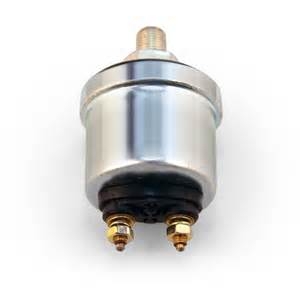

There's nothing inherently risky about mounting
a sensor right to the engine. It's done on cars
all the time . . . and probably less vibration
stress. Consider this oil pressure transducer.
[img]cid:.0[/img]
All steel structure, short moment arm, light
mass . . . risk approaching zero.

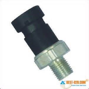

Consider this one . . .
[img]cid:.1[/img]
Hmmm . . . fatter, longer, but still steel . . .
probably still okay plugged right into the engine.
But consider the installation that demands
multiple 'sensors' . . . say one of these
fat rascals, stuck into a brass tee-fitting opposite
a low oil pressure warning switch. Now put
a not-so-close brass nipple. The high risk
joint is where the brass screws into the
engine with all that stuff hung off the
end.

Stresses that a flexible line would put on
the threads at the engine are minimal . . . if
the threads are steel . . . the risks are zero.
Risks risk sharply with high moment installations
on rigid, brass, pot-metal or aluminum, christmas-trees.

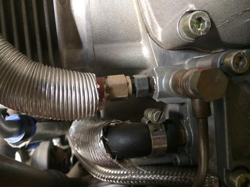

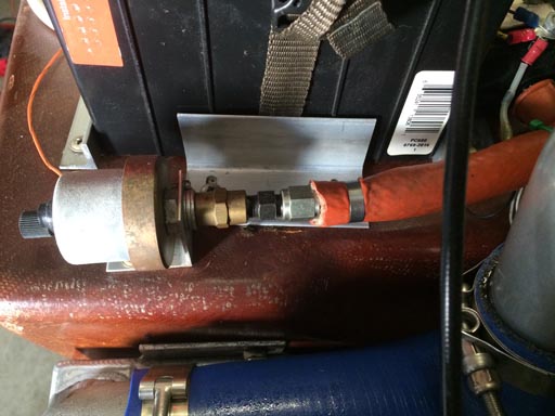

Yes, there are Al fittings on the sender in the pictures. They were only for test fitting purposes. Matter of fact, the installation ended up quite different from the build pictures. I ended up using a longer length of 666 which was routed over the engine to the sensor. It was covered in firesleeve & heat shield and tied off a couple times along the way. I also used steel fittings on the sensor. The aircraft is down for some repair work and Annual Condition Inspection so I was able to take some pictures today.

Vibration transmitted to the sensor is pretty close to zero.
The oil pressure senders died from internal failures. The either stopped sending or sent invalid readings. There were no physical failures of the attachment to the engine. Those only seemed to occur when additional fittings were installed between the sender and oil pump.
As was pointed out in another e-mail, a brass weight ring was added to the sender to modify the harmonic frequency and reduce vibration issues. I don’t know if this was effective or not. Haven’t seen any complaints of oil pressure sender failures for a couple year.
Yes, there are much different vibration issues with the Rotax. Cruise RPM in a 91X is 5000 to 5500 RPM. There’s a 2.43:1 gearbox to the prop so it is turning at .41 of the engine speed. All these things make for a challenging vibrational environment.
I’m presently building a Little Toot Sport Biplane and I will probably direct mount the oil pressure sender to the engine as it is a Lycoming IO-320.
