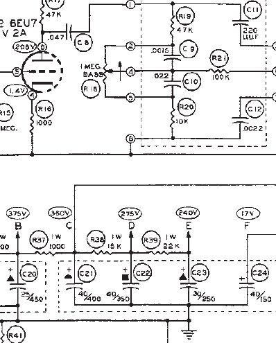

Flat/flat capacitor symbols didn't garner favor for
very long. Some of the oldest Heathkit and ARRL publications
went flat/curved for all variants of the capacitor
[img]cid:.0[/img]
