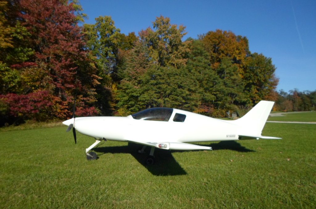

I have the 11 x 4.00 tires on my XP and I live on a 2600 ft grass strip. Just got it in October and need bigger wheels for the upcoming season. Need some info from others about what size tires they have on their Pulsars.

PostPosted: Fri Feb 21, 2014 10:40 am    Post subject: Re: Small wheels on my Pulsar XP Reply with quote
My XP
