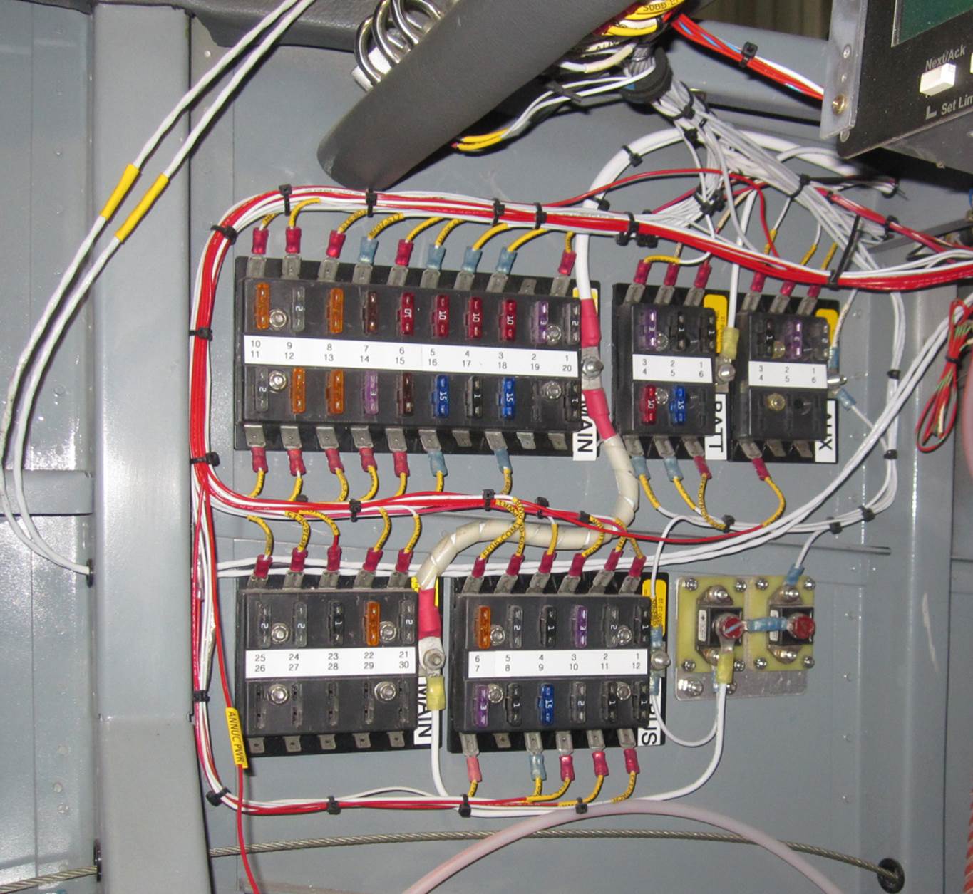

I used Bussman fuse blocks for automotive blade fuses for all my circuit protection. The tab/Faston connectors
Greg Young
- The Matronics RV6-List Email Forum -
http://www.matronics.com/Navigator?RV6-List
gyoung
Posts: 211
Location: Republic of Texas
PostPosted: Wed Mar 05, 2014 8:30 am    Post subject: Spade connectors Reply with quote
I used Bussman fuse blocks for automotive blade fuses for all my circuit protection. It has tab/Faston connectors. I use AMP PIDG (pre-insulated, diamond grip) spade connectors. They have an extra bit of metal that crimps to the wire insulation and makes a very robust connection. I would not think of soldering a tab-type connection. You can get the fuse blocks, terminals and tools from Stein Air (http://www.steinair.com) and others
