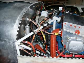

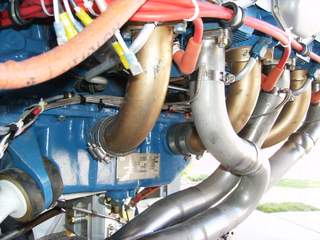

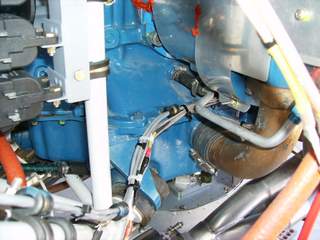

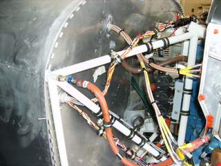

Photos attached. I have dual LSE. RG400 coming out of top portion of firewall are high tension coil wires. The bottom coils are attached to the engine mount. The top coils are attached to the engine case. Crank sensor wires route across the co-pilot side beneath the oil returns. I used both adel clamps and RTV where required. The most important thing is to run the RG400 coil wires separate from the sensor wires.

433RV - flying

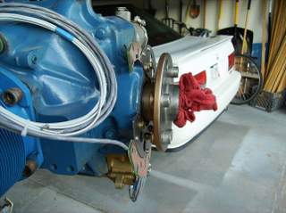

Looks good, one other thing--how about exiting the flywheel, how specifically do you route and mount the sensor wires to get the clearance from rotating flywheel? Do you mount an adel clamp to the sensor circuit board also?

The area where the sensor wires exit behind the flywheel has always bothered
me. I think I laced them together and clamped them as close to the bottom
seam of the case as possible and then back under the cyls. in a bundle with
some other engine sensor wiring. No problems at 550 hours.

Just tie them together and route under along the case using clamps and/or RTV. It's very secure. The part that me pucker was drilling holes in the case behind the flywheel to mount the LSE sensor. YMMV with newer LSE sensors.
