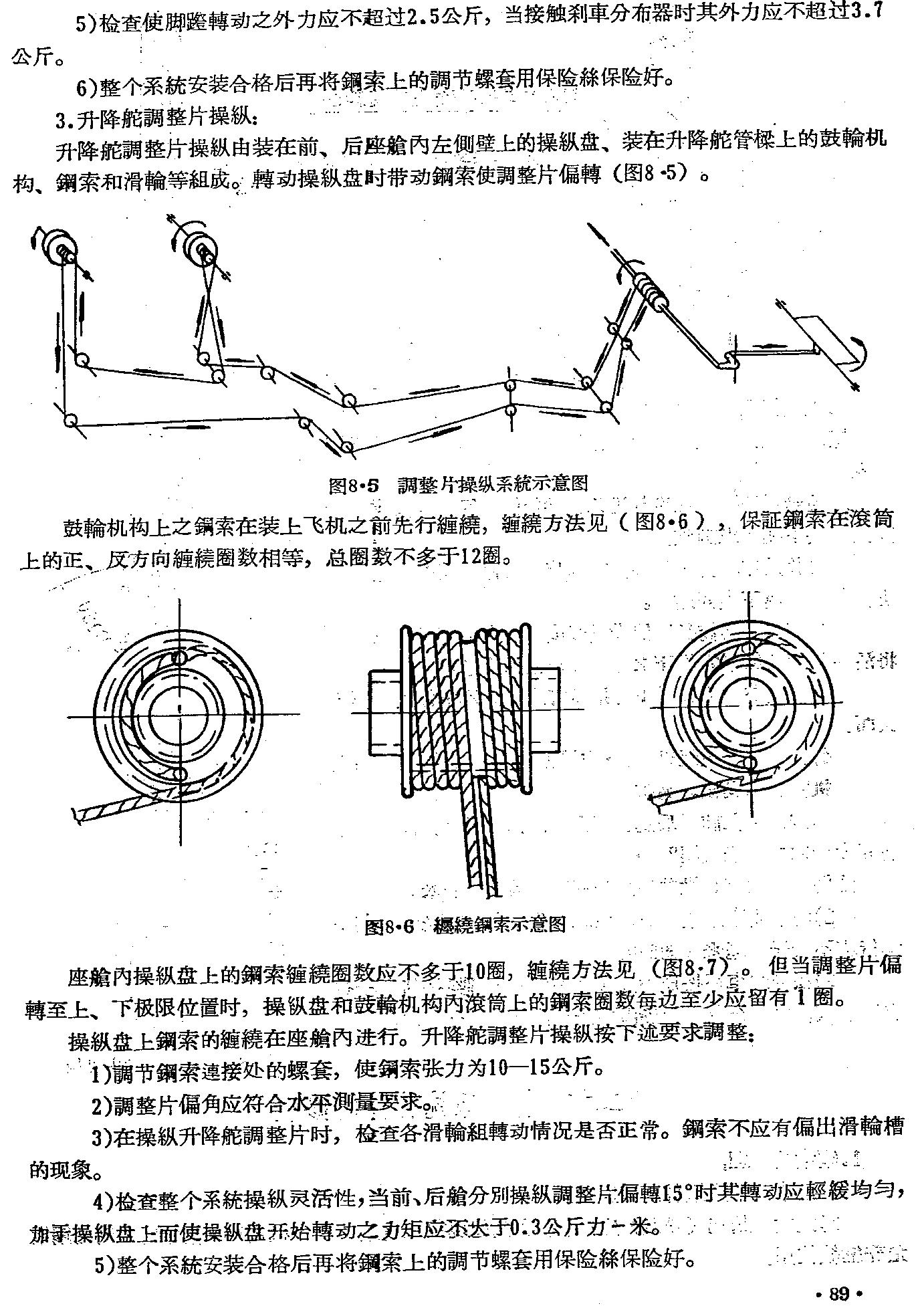

PostPosted: Sat Apr 05, 2014 10:05 am    Post subject: CJ Trim cable Reply with quote
 Filesize:  487.95 KB
 Viewed:  6373 Time(s)
kingcj6(at)aol.com
PostPosted: Sat Apr 05, 2014 10:35 am    Post subject: CJ Trim cable Reply with quote
Matt - this is helpful but I think there's a typo. In the third section, second line, the fourth character in should read "cables" (plural) not "cable".
Dave
byronmfox(at)gmail.com
PostPosted: Sat Apr 05, 2014 11:13 am    Post subject: CJ Trim cable Reply with quote
Dave, it's really a question of regional semantics. There are several dialects in China. The one prevalent in which Nanchang is located treats "cable" in the singular form for both the singular and plural like "deer" or "sheep" in English.
Blitz Fox415-307-2405
On Apr 5, 2014, at 11:34 AM, kingcj6(at)aol.com (kingcj6(at)aol.com) wrote:
[quote] Matt - this is helpful but I think there's a typo. In the third section, second line, the fourth character in should read "cables" (plural) not "cable".
Dave
salkeld
Joined: 27 Mar 2008
Posts: 8
PostPosted: Sat Apr 05, 2014 8:24 pm    Post subject: CJ Trim cable Reply with quote
Dave,
Throw in the aviation technical terminology to an already difficult dialect of Chinese does add it's challenges... While the write up may not be perfect, I did find the diagram to be much better than the ones in my Chinglish manuals, showing direction of travel and which side of the pulleys the cables ride.
I believe where you're reading "cable" in the third section, second line is correct, as it refers to the positioning and soldering of the trim neutral ball on the cable.
Also, in section 2, where they say to tie rags around the drums after winding, I personally prefer a proper set of cable blocks, though tie straps do work,
Cheers,
Matt
