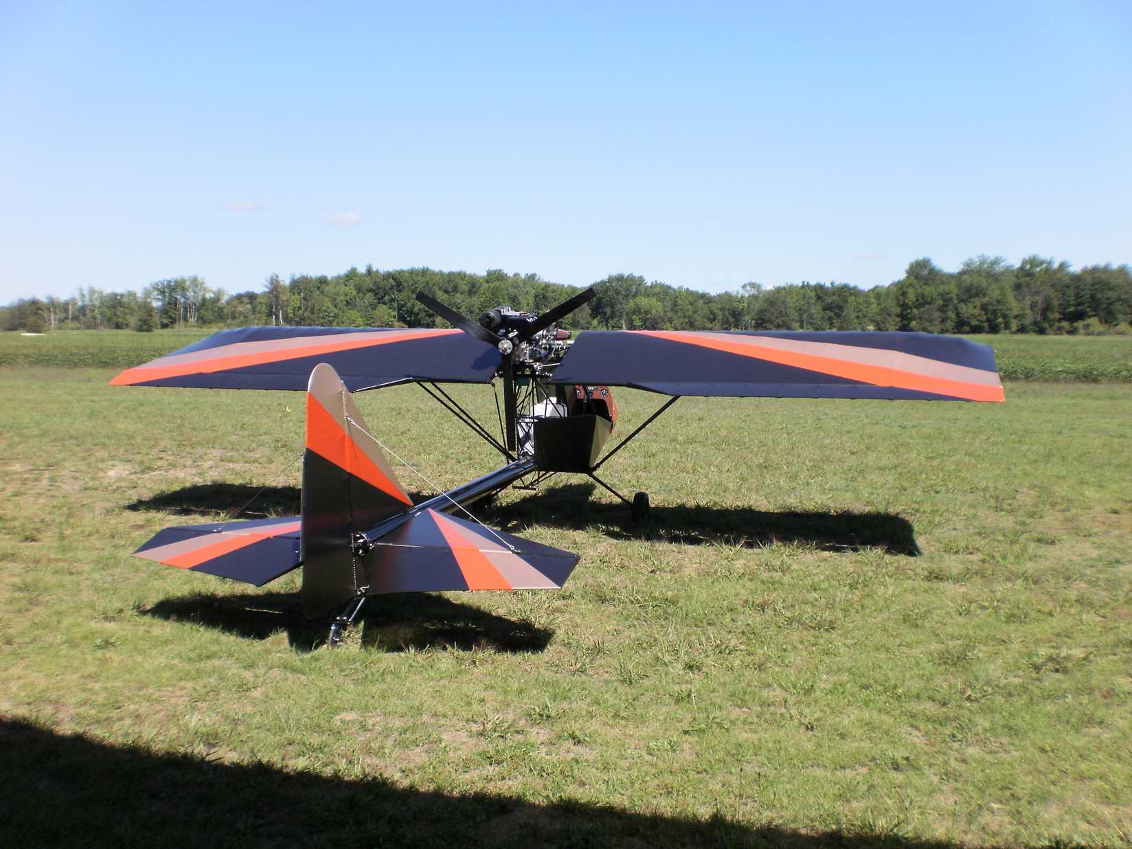

just started my 3rd season using the book binding tape. No deterioration showing up yet. My plane is hangared though. The tape is cheap and easy to install. As far as carrying your paint trim from wing through your ailerons, paint your base color first on both items. Then after the required drying time temporarily attach the hinges to the wing or the aileron using a few sheet metal screws. Your holes should have been drilled already at this point. Attach the aileron to the wing across some horses or other suitable surface large enough to accommodate the width of both making sure not to damage your base coat of paint. Lay out your trim tape as necessary with the aileron in a neutral position. Flip assembly over(with some help) and trim the other side if necessary. Disassemble, finish masking with paper and paint wing and aileron separately. It's not difficult but is time consuming. Polytone paint is very forgiving. Paint your parts horizontally as much as possible and the paint will nicely lay out if you have your gun set right. I had never painted anything ever before and I was very satisfied with the result when I was done. If you are using Polytone, just follow the book and everything will be fine.
Gregg,
That is a beautiful paint design and a beautiful piece of workmanship. Congrats!
