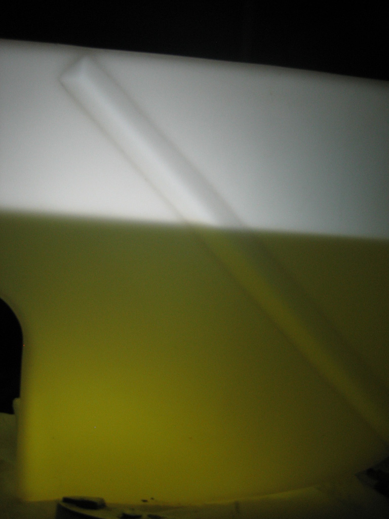

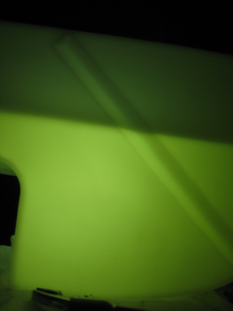

asarangan(at)gmail.com Guest
Posted: Tue Jun 17, 2014 6:03 am Post subject: Noncontact fuel level indicator |
I will take some photos and write up some details in a few days.
The idea was based on what I accidentally observed one day when
holding a flash light to the fuel tank. When the flash light is held
below the fuel level, the entire fluid lights up. When the flash light
is above the level, the tank lights up. The contrast across the fluid
level is about 10x. This is due to light being trapped above or below
the level. See attached pictures.
So, I made a board with four LEDs in a column, and another board with
10 photodetectors in a column. Using a microcontroller, I am flashing
each LED in sequence, and then computing the liquid level based on the
measured contrast. The output is displayed on a 10-bar display. The
LED board will attach to the aft of the baggage bay bulkhead, with
four holes to allow the light to get through. The detector board has
to attach somewhere on the front side of the tank. This might be the
tricky part because I need to make sure it is secure, but also
removable and does not interfere with the controls.

[quote] I will take some photos and write up some details in a few days.

One could easily make two sets of these boards and install on both
sides of the saddle.
There is a major caveat to this method - if the tank is full to the
brim, the sensor will not be able to detect the edge, so it will give
an error. Similary, if the level is below the lowest photodetector, it
will read an error. Now, there might be a way to detect those
conditions too, by checking the light intensity and color, but I
didn't go that far.
The chip is Atmel ATTiny40 and the code is in C. I can provide that so
one does not have to redevelop it.
I will post details after this weekend.

>> On Jun 17, 2014, at 7:02 AM, Andrew Sarangan <asarangan(at)gmail.com> wrote:
