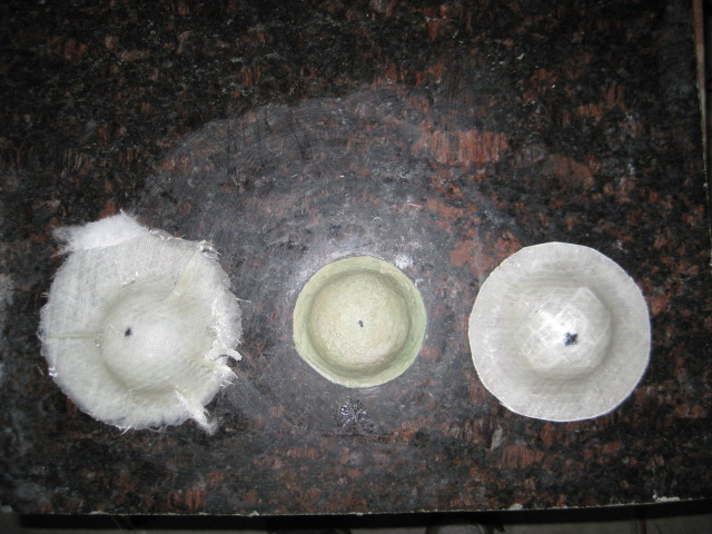

Sorry to hear about your problem.
I made my own .... vacuum bagged over the form in the middle. It's a 3" foam ball cut in half with a radius made from lightweight spackle from the aircraft aisle in Home depot.

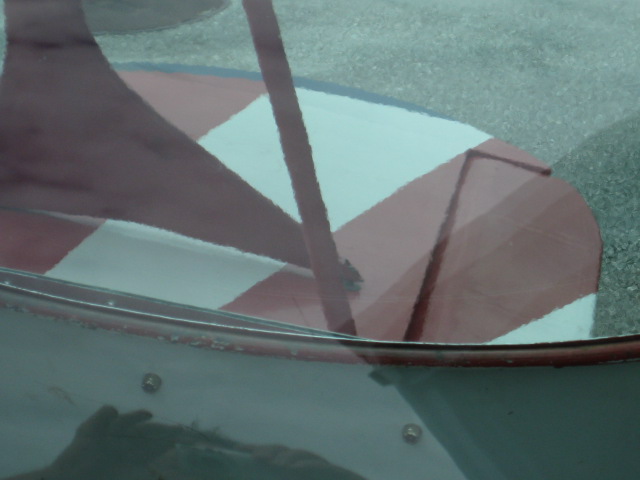

It's too bad we don't have something like Angies List for aviation ..... I bought a canopy for my Pitts from Dave Garmann at Planecanopies.com.
I worked hard trimming it to make it fit and when I pulled the plastic off It was wrinkled all down the right side ....
He won't return my calls and won't make good of the POS he sent me.

Linn, nice work! What do you use for vacuum? I have a tiny medical vacuum pump, and it works great for small stuff like this, but not enough on a bigger sheet.

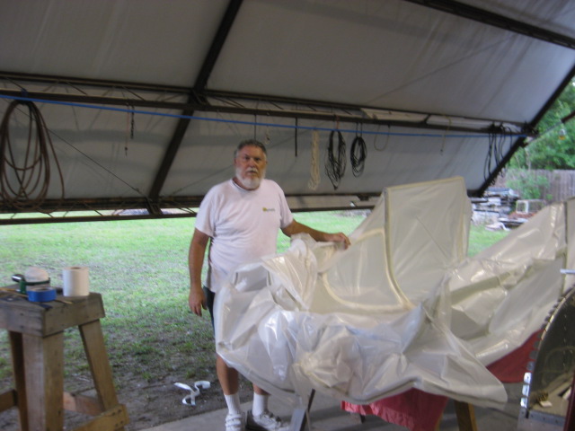

I used the larger Harbor Freight vacuum pump. It was on sale.
When I made my overhead plenum I made the form out of blue foam and bagged the whole cabin top!
[img]cid:part1.07010002.02000005(at)cfl.rr.com[/img]
Linn
