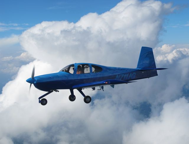

PostPosted: Thu Jul 10, 2014 3:50 am    Post subject: Re: Access to tire vale stems Reply with quote
Try going pantless, like me....
John
