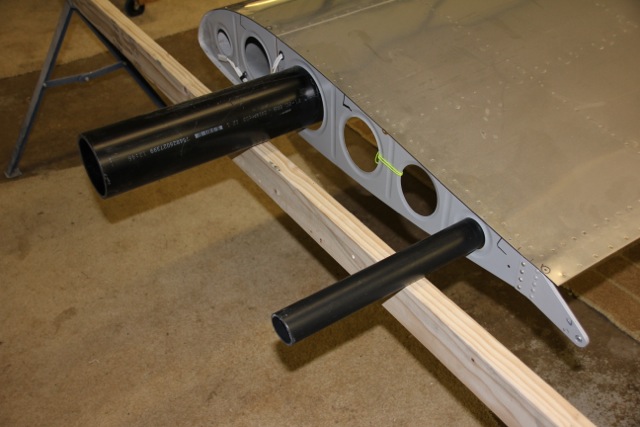

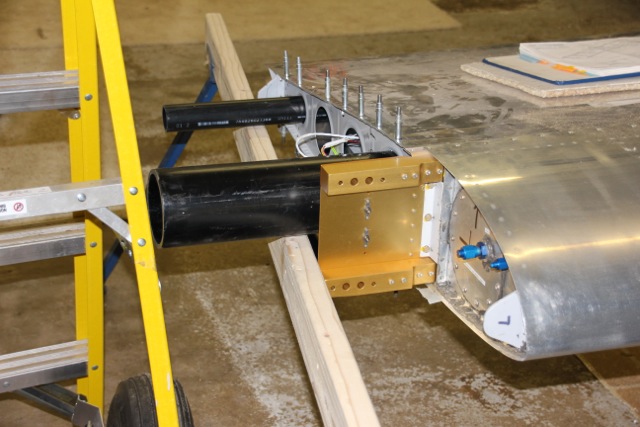

PostPosted: Tue Aug 19, 2014 7:14 am    Post subject: Rotating wing stands Reply with quote
This is my version of the wing rotator on a 9.
8 Ft 2x4 with legs to make a saw horse. Two 8 Ft lengths of PVC pipe. One 2 inch for rear rib hole the other sized to fit the rib hole aft of spar. Cut in half and insert into both ends o the wing.
Easy to flip wing to install stuff. For riveting I used a second set of saw horses with carpet padding on the 2x4 s.
Good Luck.

PostPosted: Tue Aug 19, 2014 1:22 pm    Post subject: Rotating wing stands Reply with quote
Thanks William
That's a simple and inexpensive solution.
Carlos

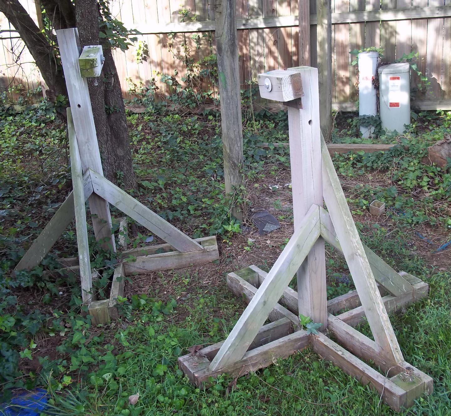

PostPosted: Fri Aug 22, 2014 5:12 am    Post subject: Rotating wing stands Reply with quote
See if this pic comes through, Carlos. Basically, bolt the wing spar to the
swivel block on one stand, make "sandwich" 2x4's to attach to the end rib
on the tip end and bolt to the other stand.
Later, - Lew

PostPosted: Fri Aug 22, 2014 5:28 am    Post subject: Rotating wing stands Reply with quote
Id did come through.
Thanks a lot
Carlos
