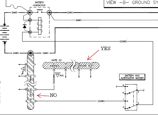

The ELT is not a candidate for grounding on the firewall forest of tabs (POWER STUFF). This is a piece of avionics. First, when the ELT is mounted in the airplane, is there any continuity between the power(-) wire that runs forward and ship's ground? I would hope not but it doesn't hurt to check. I would plan on grounding this article at the avionics ground on the panel.
[img]cid:7.1.0.9.0.20140826113749.04d509a8(at)aeroelectric.com.0[/img] [/b]
If I use a shielded 20 gauge wire from the GPS down to join the three wire from the rear, I need to figure out how to connect it to the GPS designated wire in the three wire bundle. Specifically, how to deal with the shielding. Should I ground it all at the firewall and somehow solder the shields from the three wire and single wire together? Should the GPS lead be grounded both at the firewall and at the GPS ground block?

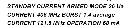

Man! This is a pretty sorry manual considering all the
$time$ that somebody spent putting it together. There's
lots of data, probably accurate for the most part, but
horribly organized and formatted. On page 15 we find
this statement.
[img]cid:.0[/img]
The IMPORTANT item is 26 MICROAMPS standby current. This
means that lead is best fed from ship's battery bus. It
also says 1.4A average for 406 burst mode which has to be
bogus. It's got to be 1.4 amps for DURATION OF BURST with
something much lower between bursts. What's notably missing
is the ENERGY loading on this wire . . . which presumes that
the ELT's internal battery is depleted. Elsewhere we see
a "40 mA" tag on that wire . . . which may be the current
draw between bursts.
The RS232 "SEND TEST LINE" appears to be used only as
a LED driver to register acknowledgement of a GPS data
string on the "RECEIVE" line. I'd wire a resistor/LED into the
system permanently as opposed to the temporary jig
illustrated. This would function much as the REPLY
light on a transponder . . . a general tell-tale on the
systems operational state.
The power(-) lead should go to your avionics ground
Power(+) to the battery bus . . . use a 3A fuse.
RS232 RECEIVE connects to the RS232 SEND line
of your GPS receiver.
