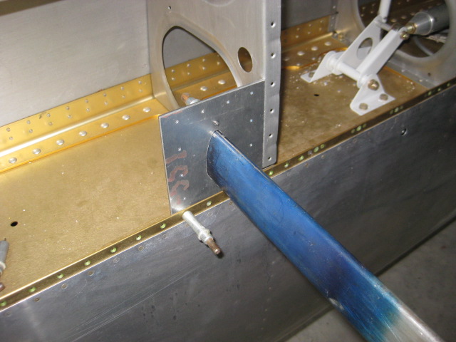

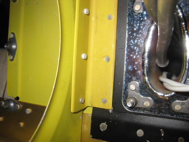

I put mine in the next bay outboard of the aileron bracket. Made my own mast .... because I could. I haven't riveted the bottom panel yet but you can work through the inspection panel. I used the Van's pitot (the hole below the bracket) with a 45 fitting for my AOA.
Linn .... final sanding the windshield fairing

Pitot is about half way, pretty much where Linn has his, I didn’t rivet the
bottom skins until the end, pretty much when the skins where riveted
everything in the wing was installed and bolted down.I did have it clecoed
for the pitot install and fitting of tubes.
Pascal

I put my mast out in the last or next to last bay per some other
builders. I have the Gretz heated pitot and it has a little controller
that resides close to the mast so the last bay provides easy access via
the tip. No problems with the location.
