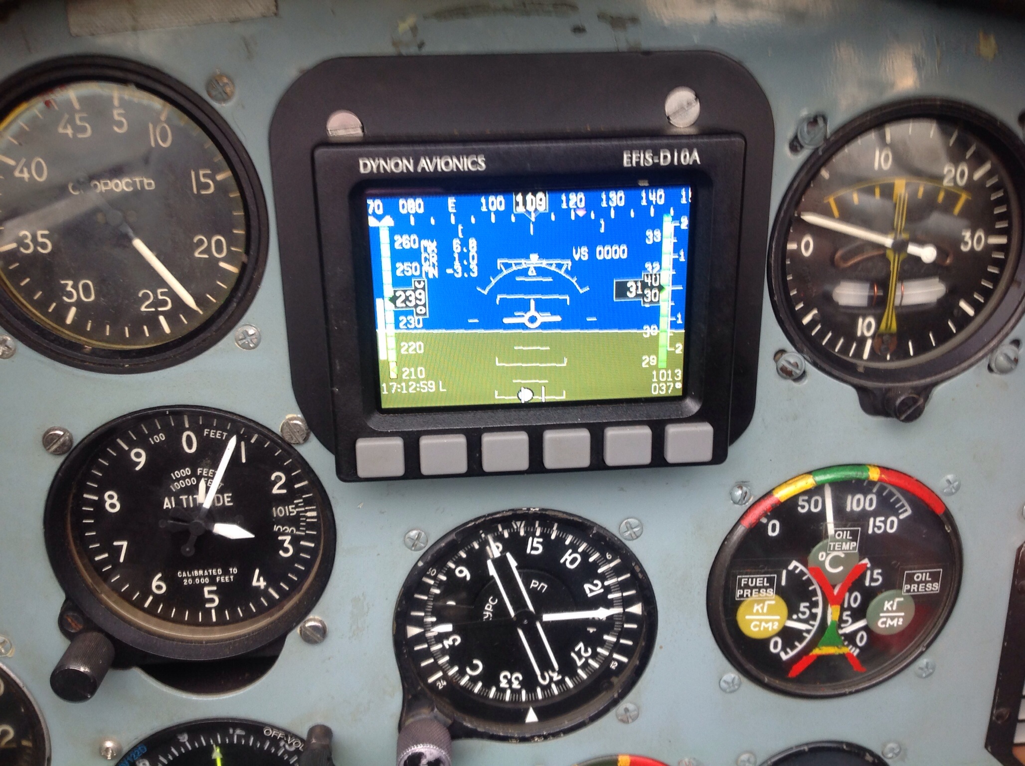

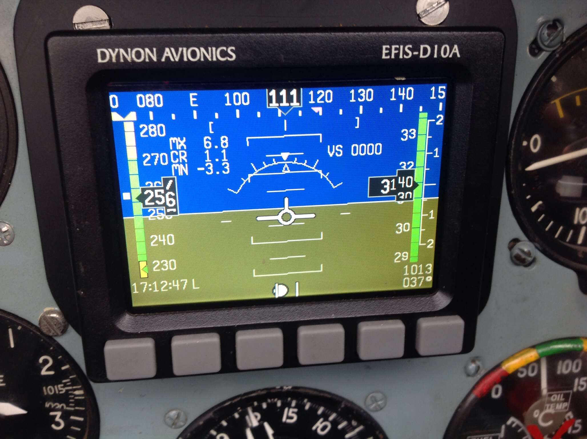

But to answer your specific issue of installing equipments in Yaks, Hans,
your best port of call is probably the UK CAA itself.
Or contacting people dealing with Yaks in the UK, Richard of course, Yak UK
(they installed a DYNON EFIS - D10A in our Yak-52, see photo attached),
http://www.aerobuzz.fr/IMG/jpg/image-17.jpg
Horizon Aircraft Services in St Athan (EGDX), Wales :
http://www.horizonaircraft.co.uk/maintenance.html
https://www.flickr.com/photos/62441905(at)N03/14331355930/
https://www.flickr.com/photos/62441905(at)N03/14494914066/
my friend Jez Hopkinson from the YAKOVLEVS formation aerobatic display team.
He has installed EFIS (and Garmin GNS 530) in all his Yak-50 / Yak-52.
http://www.yakovlevs.com/team-yakovlevs/our-aircraft/
http://www.yakovlevs.com/wp-content/gallery/aircraft/img_0332.jpg
http://www.yakovlevs.com/wp-content/gallery/aircraft/cockpit.jpg
Anyway having said all that, installation of an EFIS is a good idea if you do a little be of travelling with your flying machine.
I decided to install the Dynon D10A a few years ago after flying
for 45 minutes in clouds coming back from the South of France
(a 4 hour 15 minutes flight) with my wife and our little dog in the back seat ...
I had to fly with a constant 5 degree of bank on the Russian Attitude Indicator
to stop the compass indicator from slowly spinning, trying to maintain a constant heading to get us home.
Since then I had the opportunity to use the Dynon Artificial Horizon quite a few times going places for Airshows
or coming back to base in less than ideal weather condition.
Quite a few missions I would not have been able to complete without it.
So highly recommended. I would not trust the Russian horizon installed in 99.9 % of Yaks.
VoilΓ  Hans, hope you will have an EFIS installed in your Yak soon.

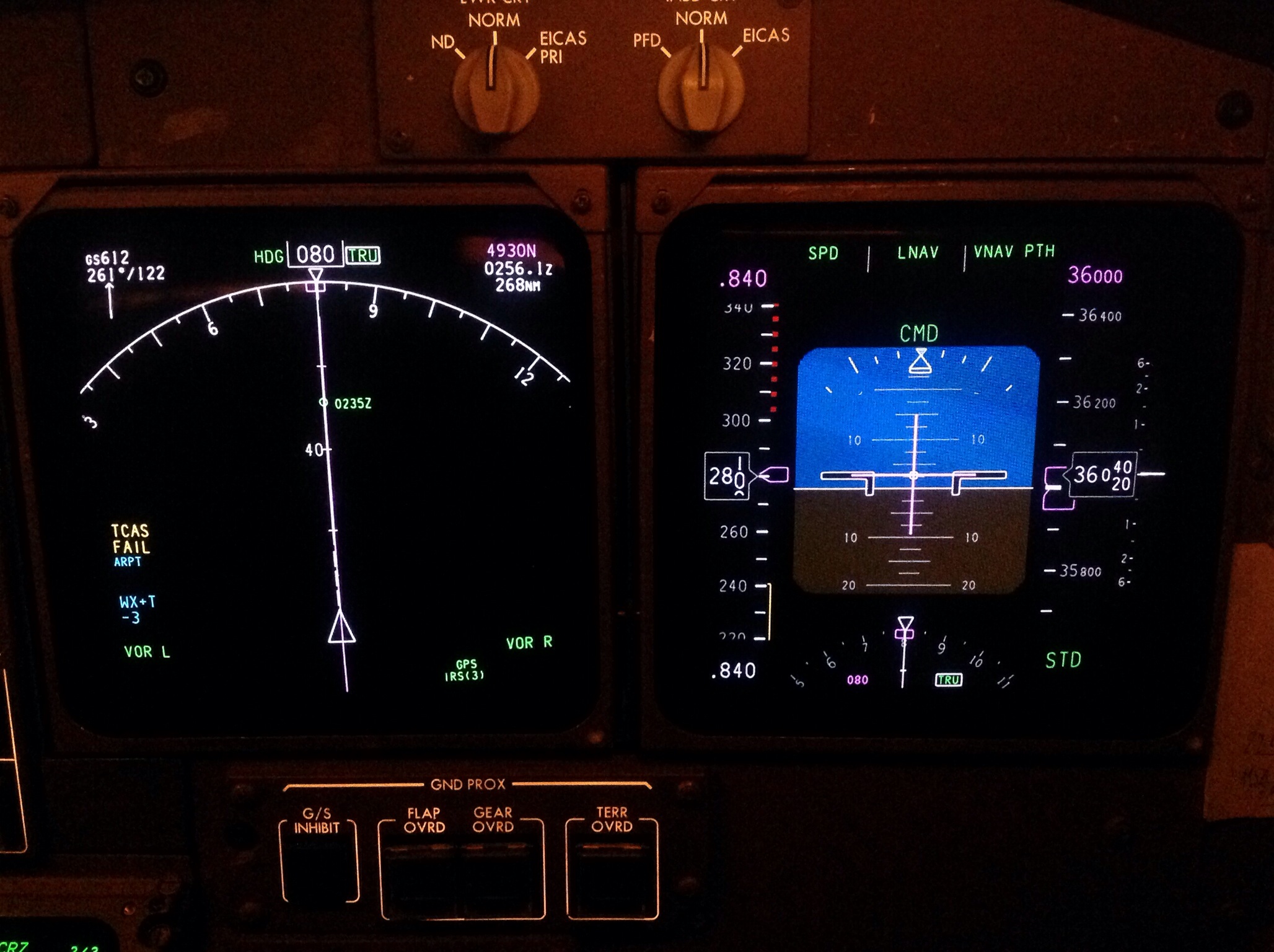

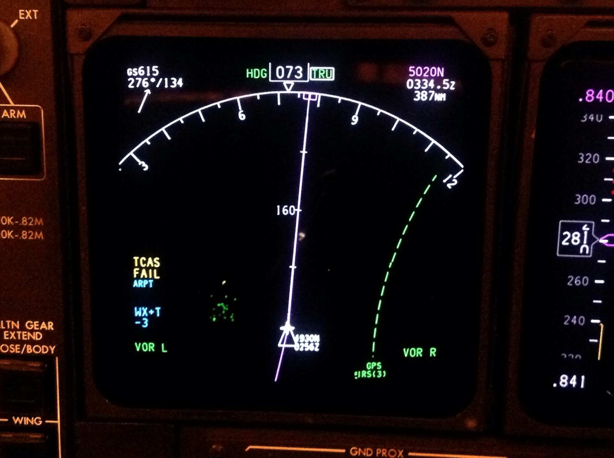

Oops ... Exclamation
# Have sent photo of 747 EFIS ... Instead of Yak-52 !
http://forums.matronics.com//files/image_299.jpg
# Ground Speed of 612 knots with a 122 it's Tail Wind
would be interesting in a Yak-52 ...
Photo was taken during night flight across the Pond, from JFK
on our way to LHR on course to 30 degrees West (Mid-Atlantic)
FL 360 / M.84 at 02.56 in the morning ...
# Anyway find photo of Dynon EFIS D10A installed in our Yak
Attached below.
Cheers, Etienne.

Hi Doc,
using the RMU gyro for the DYNON EFIS -D10A.
And an extra pitot tube. Static from the main.
KR, Etienne.
