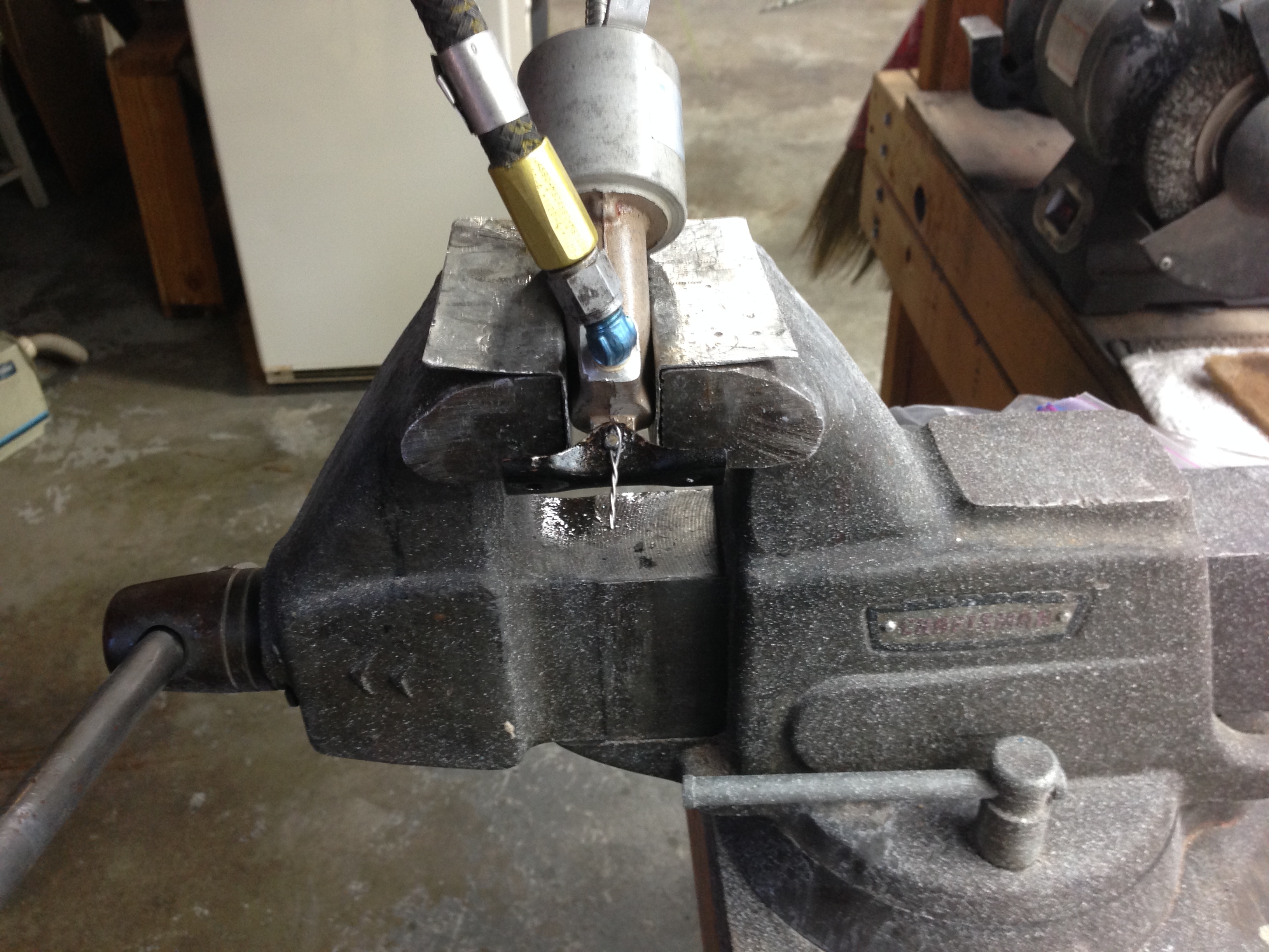

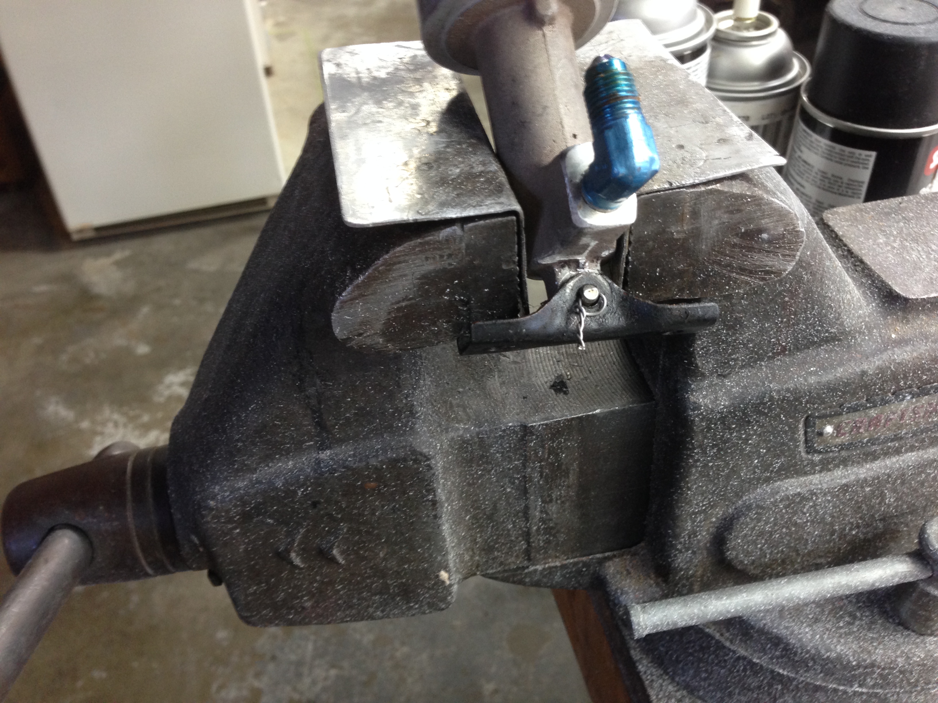

Owner says he paid a guy to overhaul the Master Cylinders.
NEWS FLASH: Not only was safety wire used in place of a washer and cotter pin, the shafts are bent.
The safety wire was worn almost all the way through.
