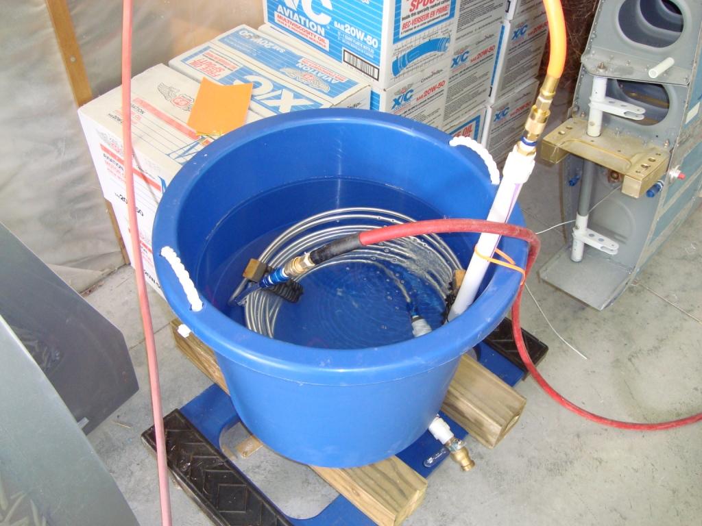

Attached is a homemade air/water separator that did a very nice job for me.
Note the water drain valve. Fill the tub with water and ice.

More questions on the water separator ...... which is air in and out?
Describe the stuff at the bottom of the vertical pipe .... and the drain valve ... that's hidden by the tub.

There are a lot of ways to do this.  This example uses a coil of 3/8” aluminum tubing from Aircraft Spruce and some standard fittings.  The coil shape is maintained by three pieces of wood and tie wraps.  The air goes in at the top (red hose).  The coil ends at a PVC “T” fitting.  The opposite side of the “T” fitting connects via PVC fittings, out a hole in the side of the tub and to the brass drain valve.  The top of the “T” fitting goes up out of the water where you see the yellow air out hose connected.  I also ran the out hose 6 feet or so vertically so any condensed but still entrained water would drain back down into the PVC pipe.  I blew the water out of the tub every hour or so.  I made some ice blocks from gallon milk jugs and floated about four of them in the water while painting.  When not in use empty the tube as the aluminum coil will corrode if left in water.
This water separator was the third in line from my compressor.  The first is a 10’ up run of ½” copper pipe, then a standard air filter, then this.  Without this finally water separator I got water at the paint gun.  With it I was always dry.
