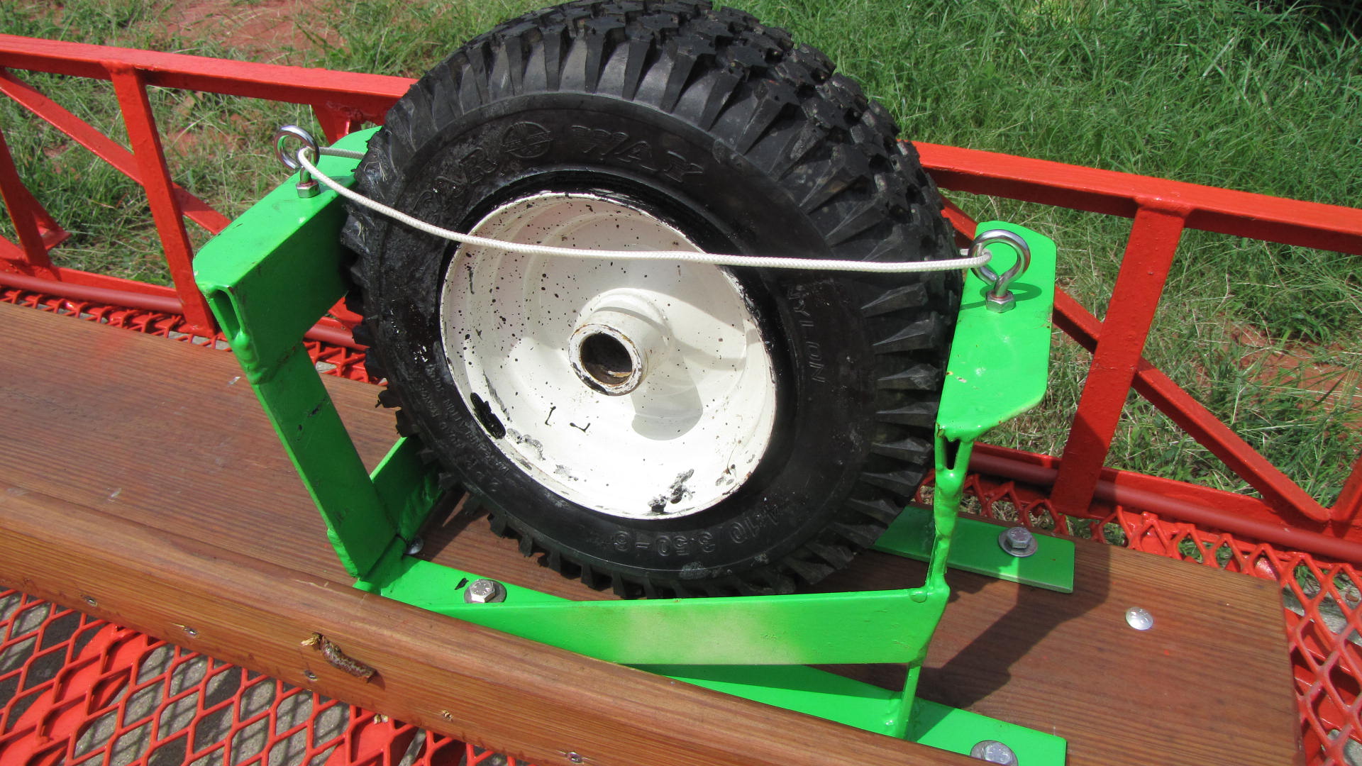

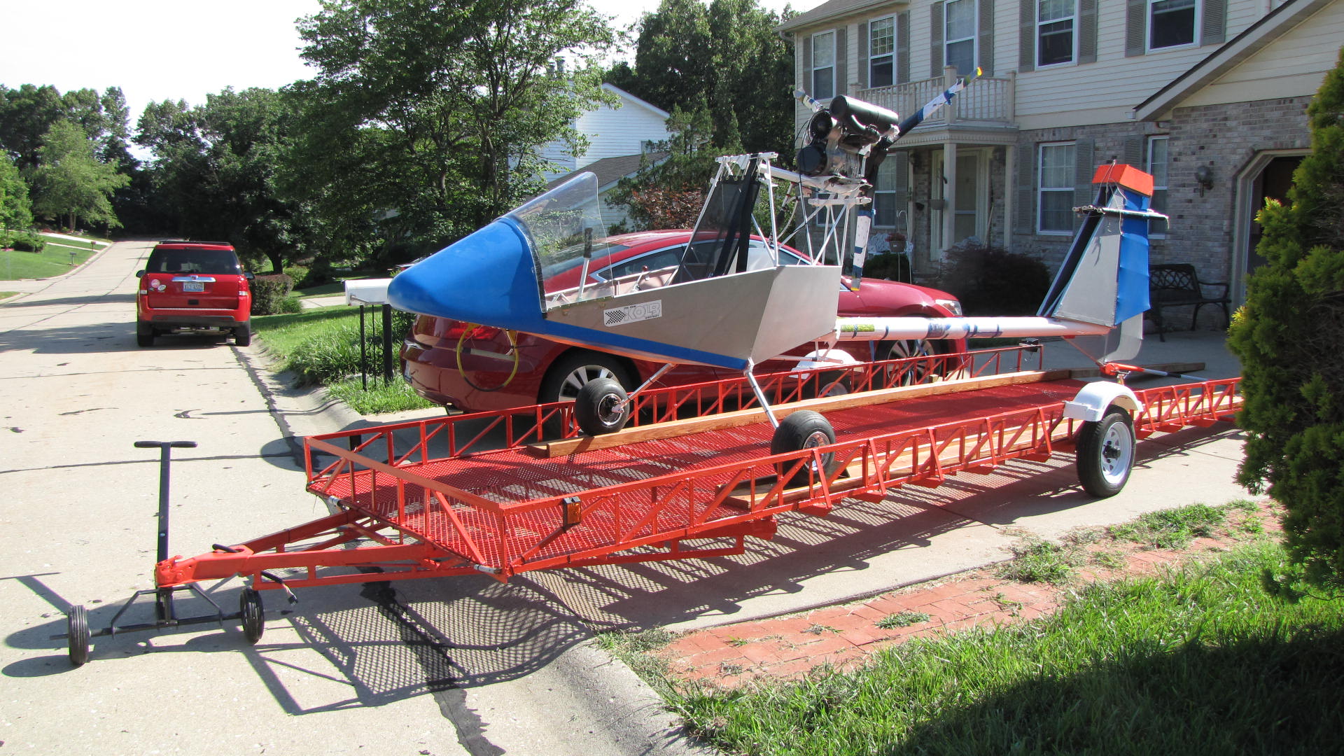

The picture shows a weldment I use to chock my wheels on a home-made 20-foot trailer, with 36-inch tongue. The wheels roll up over a hinged part that swings up to immobilize the wheel when tied up with rope. The rear of the FireFly 5-inch boom tube needs to be supported by a cradle that swings down out of the way for loading.
