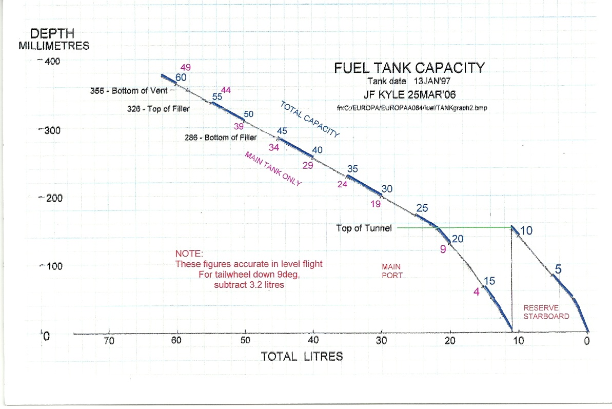

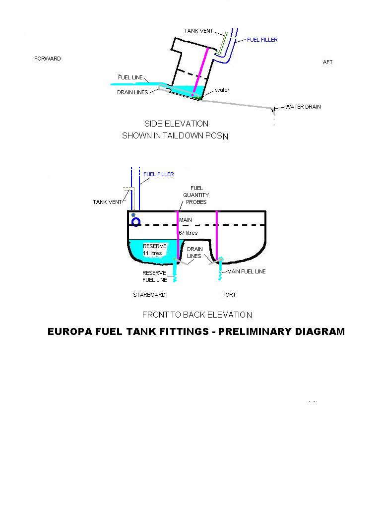

This is probably redundant because of age, but I set the tank level and added measured water against an inch scale to get the depth quantity for both the starboard standby tank and the total. I then tipped the tank 9 or so degrees (tarmac) and did it again to get the graph. My tank is 1997.
Ferg
PS: What happens to overflow fuel when you top to the filler cap?
