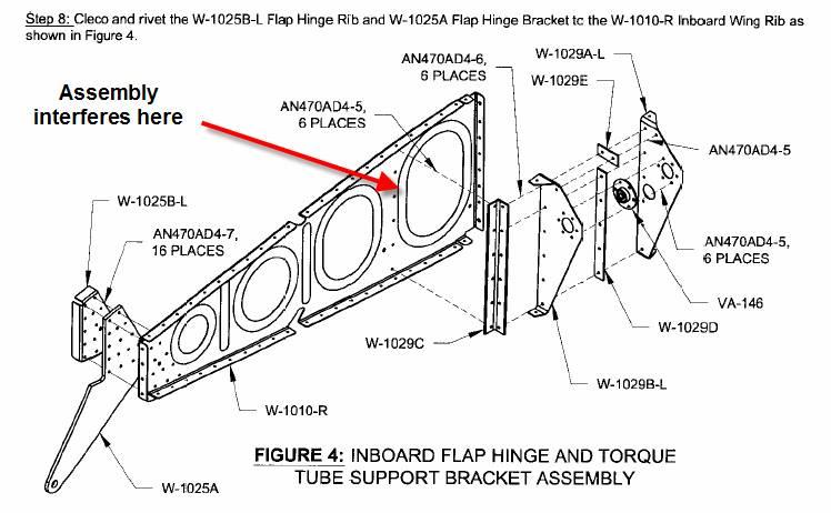

Group,
Has anyone run into the problem of the rear aileron torque tube support brackets interfering with the bead in the forward most lightening hole of the wing root ribs?
Todd

t_agold(at)yahoo.com Guest
Posted: Mon Jul 10, 2006 9:28 am Post subject: torque tube support attach to wing root rib |
Eric,
Thanks for the reply, but I'm referring to a different issue. See picture...
Todd

rv10(at)tpg.com.au Guest
Posted: Mon Jul 10, 2006 10:33 am Post subject: torque tube support attach to wing root rib |
Hey Todd,
Just did this a couple of days ago and also sat scratching my head for some time after striking the
same problem. I also spent some time searching through the lists thinking "Surely someone else
has had this problem!!" In the end I ground the bottom of the support brackets back to provide
clearance at which point they sat in there semi-nicely (still had headaches getting the holes
common to the flanges even close to lining up).
Have fun,
Scott Lewis

jesse(at)itecusa.org Guest
Posted: Mon Jul 10, 2006 11:01 am Post subject: torque tube support attach to wing root rib |
I had to do that as well. Just grind down, file down, whatever-down the angle until it sits flat.
Todd
#362

Posted: Mon Jul 10, 2006 11:13 am Post subject: torque tube support attach to wing root rib |
The old Yahoo list had a bunch of info about this but alas it tis gone so for us old Yahoo guys who remember, this is what I recall:
Some had clearance issues, some didn't, and if you do, it's a VERY LITTLE amount of interference. My right bracket just interfered (only right) with the bead so I buffed off the slightest amount of material off the bottom of the bracket and it worked fine.
Later someone posted that Van's said to flatten the bead slightly to allow the bracket to sit properly. I know this sounds dumb but make sure the angle is aft of the bracket and not forward which would make it sit right on top of the bead. Carefully line up the spacer and bracket to make sure your not to far forward when you match drill. If the bracket is sitting really high up on the bead, something is wrong somewhere. You should only have to round the edge of the bracket a small amount for it to come together correctly.
Rick S.

Posted: Mon Jul 10, 2006 11:44 am Post subject: torque tube support attach to wing root rib |
The beads act as stiffeners. Adding that attach point stiffens it way
more than a bead. I do recall the comments in the past about flattening
it which is a better idea than removing any material. I believe that is
what I did also.

Posted: Mon Jul 10, 2006 1:13 pm Post subject: torque tube support attach to wing root rib |
That problem is common. My kit #40192 had it too.
Van support will tell you to flatten out the rib.
Jim C

Posted: Tue Jul 11, 2006 5:57 am Post subject: torque tube support attach to wing root rib |
I remembered from seeing Rob's old repost a bit more on this
spot. I think it touches, but once you have the ailerons
hooked up, you can't get that much travel out of it
anymore, so then it no longer rubs. So for those who are
looking at this and worrying about it, you may want to wait
until you attach your ailerons. I don't think I ended up having
to bend mine in, but I also don't think they rub. If someone
else had a different experience, please post to disagree, but
if someone had the same experience, it would be nice to hear
that this is valid...just in case.

Posted: Tue Jul 11, 2006 6:53 am Post subject: torque tube support attach to wing root rib |
My experience is the same as Tim's - once on the wing my ailerons do not rub.

Posted: Tue Jul 11, 2006 7:47 am Post subject: torque tube support attach to wing root rib |
Hello all,
First off, I've been lurking on this list for a few weeks to get a feel of what's going on with building an RV-10 since I've decided this airplane will fit my requirements. I'm still a few months away from actually ordering a kit ( other issues need to be worked on, especially final approval from the household finance minister!). And while lurking I've thought about giving some opinion about a few of these issues and this discussion seems a pretty good place to start. Let me give you my bonafides first. I work for a rather large midwestern producer of military aircraft (guess who!) as a structural design engineer specializing in production support for 17 years. Dealing with problems associated with aircraft assembly is my profession. I've held a private pilot's license since 1989 and owned a Grumman AA-1A for nearly nine years. However, I've only been flying very intermittently since selling my airplane a few years ago. This is why the RV-10 looks really attractive to me, good design, easy (relative) building and four seats for the whole family (wife and two girls now 11 and 6) for those trips we could make by air.
Now about this problem: It is my opinion that if at all possible do not flatten or trim the stiffening bead around the cutout in the inboard closure rib. Looking at the figure sent, it appears that the issue is that the outside of the bent section of the W-1029C angle rides on the initial bend radius of the W-1010R rib when located to the matched holes in the rib. First off, the stiffening bead is there so that the rib will not buckle under the maximum shear load seen by the rib. It may seem counter-intuitive, but a rib such as this can actually take a higher shear load with the cutouts and stiffening beads than if the rib had a solid web. If it is absolutely necessary to flatten or trim the bead off for clearance, then it is best to add a stiffening doubler to the opposite side of the rib to help keep the rib from buckling locally.
However, looking at the picture, I'm not sure there is a need to "adjust" this bead. I have to ask some questions (and since I don't have an airplane to look at either) about the rib. Does the bead bend convex inboard or outboard of the web? And since the picture doesn't give me orientation, is the torque tube support assy installed on the inboard or outboard side. Also, are the left hand and right hand closure ribs identical or are they mirror images of each other? It seems to me that if the beads convex outboard and the bracket assy is installed to the inboard surface, there should be no interference. The only issue you'd have is an "overhang" which structurally isn't an issue as long as the heads and tails of the MS20470 rivets attaching the bracket doesn't ride in the bead radius. And if the two ribs are mirror images, your problem could be a mis-identified or mis-formed rib. Swapping left for right might solve the problem, but hole alignments to skins and spars may be off.
While the typical aircraft design is rather robust and can stand some deviation from design ideal, too much alteration without checking with the factory or other professional could be a bad thing. Fully flattening rib stiffening beads qualifies as a major alteration to me.
James K. Hovis
Posted: Tue Jul 11, 2006 8:26 am Post subject: torque tube support attach to wing root rib |
James,
I sent Van's an email and got back a reply to flatten the bead. I understand you concerns, but hopefully the following answers to your questions will clarify the issue.
Does the bead bend convex inboard or outboard of the web? - Convex. The bead is on the same side as the flange.
is the torque tube support assy installed on the inboard or outboard side. Inboard. The flange also faces inboard.
Also, are the left hand and right hand closure ribs identical or are they mirror images of each other? -Mirror images
, your problem could be a mis-identified or mis-formed rib. -The edge of the lightening hole doesn't exactly line up with the line of holes for the stiffening angle.
Swapping left for right might solve the problem, Can't do that. Nothing will line up and I don't think it could even be assembled that way.
Once the torque tube support is installed, the rib is MUCH stiffer that with the bead. I only flattened the portion of the bead that interfered.
Todd #362
todd agold wrote:
>Thanks all for the replies. It made the most sense to me to
>flatten the bead in the interfering area. I tried it last night
>and all turned out well.
> Thanks again.
>Todd
>#362

james.k.hovis(at)gmail.co Guest
Posted: Tue Jul 11, 2006 8:58 am Post subject: torque tube support attach to wing root rib |
Thanks for the info! If the guys at Van's say to flatten the bead, then flatten the bead. Seems that a simple solution for future kits is for Van's to change the production process and swap the direction they apply the bead. Yes, the angle itself will add stiffness to the rib after the bead is flattened. And if only a portion is flattened, then you still have some of the original intent to stiffen around the cutout being effective. However, the support bracket is adding a shear load into the web and all things being equal, the conservative engineer in me will tell you to add a doubler to the opposite side. But, the loadings seen by each discreet part may not happen at the same time. The maximum shear reacted by the rib from the wing skins may not be at Va, it is most likely a walking load from a person on the wing-walk area since this is a closure rib and the support bracket sees its maximum load in the unlikely event of a control jam. Since Van's looked at the problem I'd go with their recommendation.
JKH
On 7/11/06, todd agold <t_agold(at)yahoo.com (t_agold(at)yahoo.com)> wrote: [quote] James,
Todd #362
James K Hovis <james.k.hovis(at)gmail.com (james.k.hovis(at)gmail.com)> wrote:
[quote] Hello all,
James K. Hovis

Rick S.
Joined: 12 Feb 2006 Posts: 347 Location: Las Vegas
Posted: Tue Jul 11, 2006 10:22 am Post subject: torque tube support attach to wing root rib |
Yeah...like I said flatten the bead, we are only talking depressing the very edge of the bead on one side then riveting a robust .125 angle right next to it that is secured to the rib, top and bottom skins. When you finish this assembly it is strong as can be. It ain't an F-18.
Don't expect Van's to change the hydroform molds for the ribs until the existing one wears out, that costs money, which shuld be used to improve the quality of the (at)#$!(at)#%^ fiberglass top.
Rick S.
40185
_________________ Rick S.
RV-10
40185 |
