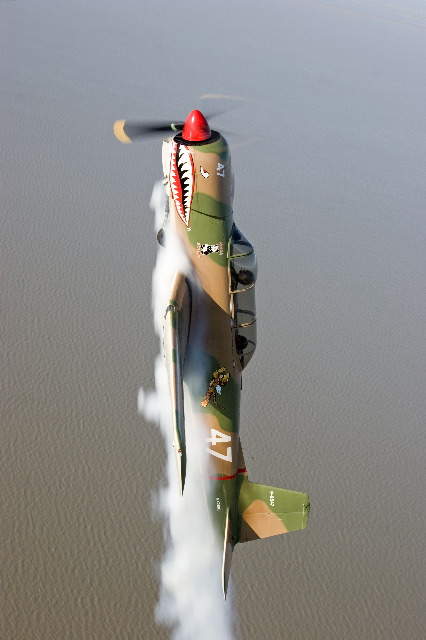

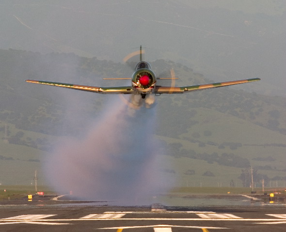

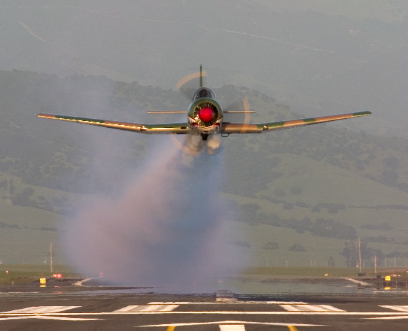

Smoke.  Bill Blackwell installed the system on my personal bird a year ago, and it puts out copious amounts of smoke.  The important thing is the pressure....make sure to use a pump that will deliver at least 60 psi and adjust the flow valve and restrictors at the injectors to get the optimum burn....nozzle placement doesn't seem to make a lot of difference in Bill's experience.
[img]cid:8FFFD832-B35D-4EEC-B0DD-8C280D9F29E8(at)local[/img]
[img]cid:37945F28-5B51-4AD4-A581-7363DB1076FE(at)local[/img]
