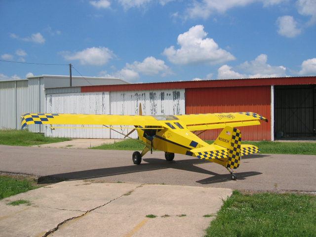

thanks dave, here is a picture of my fox.
