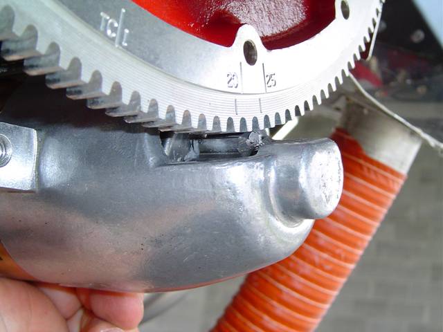

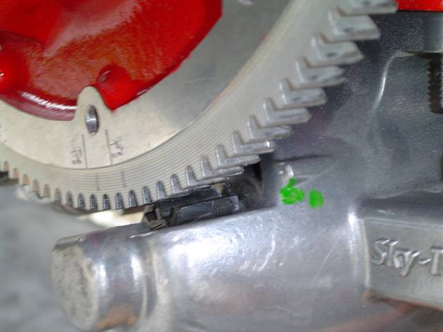

I took a hard look at the starter again and there appears to be no damage anywhere, other than what you get when spinning parts touch each other without engaging.  No cracks, etc.  I’ve attached a couple pictures in case that helps someone decipher what’s going on.
It is a Sky-tec starter on an Aerosport IO-540A4D5.  I was wondering if there’s any chance the starter comes with different size gears and perhaps I got the smaller version?  The odd thing is it worked great for awhile.  I cranked it for almost 10 seconds before I realized fuel wasn’t getting to the engine yet and it spun great.  Then it worked a few more times before the engine came to life.  After that it was nothing but trouble.
Marcus

I finally got to start my engine today for the first time which was quite motivational.  However, after letting it run for a couple minutes and checking it over for leaks I tried to start it again.  This time I was greeted by a horrendous squeal and the prop not spinning as fast as before while starting.  I shut it all down and it appears the starter is no longer engaging properly.  It wore a little of the outside aft edge of the flywheel and looks like either the starter gear is too small, or somehow it suddenly was able to drift a little further from the flywheel and no longer mates up properly.  The starter mount nuts look secure and the factory paint cues are still in place so I am stumped.  With the starter gear retracted it looks like the gears will just barely overlap when it extends.
I am open to any and all thoughts, theories and suggestions.

PostPosted: Sun Jul 23, 2006 5:11 pm    Post subject: Starter Problem - update Reply with quote
Marcus,
It's hard to tell but the gear pitch does not look the same.
I went to the Skytech Web site and found a PDF showing the correct starter for a given engine.
http://www.skytecair.com/Fit_Guide.htm
You might check this out.

PostPosted: Sun Jul 23, 2006 5:31 pm    Post subject: Starter Problem - update Reply with quote
I do know that in general there are different numbers of teeth, depending on your flywheel . . .

Thanks for the effort, very helpful. Mine is a model 149-12LSX which
(except for the X which I assume is for experimental) it should be good to
go.

Marcus, I am at OSH and the connection is poor but your picture indicates the starter is mounted about 0.25" low of the flywheel. With the mount the way it is, I would think this starter gear has a smaller diameter than necessary. Aerosport should be good about a correction.

Starter and ring gears do come with different tooth counts. If memory serves me correctly it is 122 or 149 tooth count. This refers to the number of teeth on the ring gear. By counting the teeth you can confirm the ring gear. For the starter you will need to refer to the manufacture for the tooth count. Obviously mixing a ring gear for one count/pitch and the starter for the other count/pitch is a bad thing.

Thanks to all for the inputs.  I spoke to Bart from Aero Sport at Oshkosh and he said that if there was a kickback then the starter is designed to bend the shaft and will result in my situation.  They are paying for overnight FedEx for a quick repair and back to me hopefully in time to have the airplane inspected on Sunday.  FWIW everyone I spoke to at Aero Sport about this was absolutely fantastic.

Do you remember any kickback???
The most common cause of kickback is the non-impulse mag firing 25 DBTDC (or whatever your engine is set at) so you might want to check your mag wiring.  If you only have a OFF/L/R/BOTH switch and a starter button ..... start on the left mag and switch to both after it's started.  Standard switches with OFF/L/R/BOTH/START disable the right mag ...... if you have it wired up correctly.

    I think I heard it kickback, but it was all kind of a blur to be honest.  I have an impulse mag on the left and a Lightspeed system on the right.  I plan to double check the wiring and mimic what several (Tim Olson, etc) mentioned in a previous post.
Any and all kickback preventative measures relating to this setup would be welcome.

Yeah, it looks like not much gear meshing going on. I saw
the other posts about talking to aerosport and the bent shaft
thing. I'll have to catch up on the thread, but if the shaft
isn't bent, my next step would be to make sure it's mounted as
close as it needs to be.
