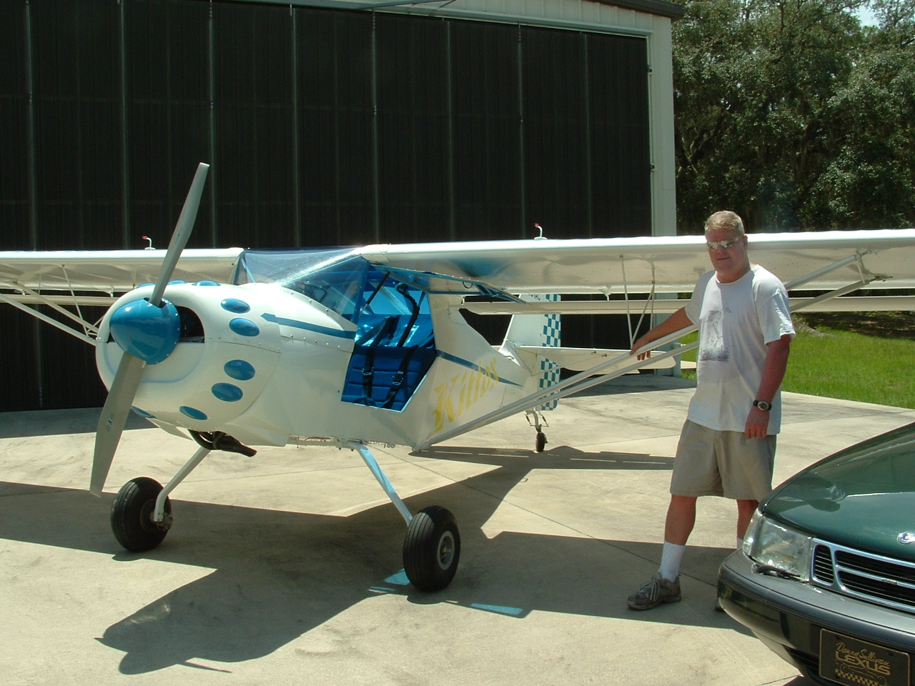

ps I have attached a picture of my completed bird,another member of the fox family.....
 Sincerely     Mark Thomson   N61AC

dave(at)cfisher.com
PostPosted: Tue Jul 25, 2006 4:13 am    Post subject: rpm cruise? Reply with quote
Mark,
Very nice looking Kitfox.
I assume by the short prop your are running direct drive ?
I think the VW like to run higher rpm that 2500 in cruise so your cruise would be higher in that case.
You have a heavy IV at 753 so with the short prop and heavy weight 600 fpm not that bad really in your climate.   Wait till cooler days and see how it is.
I read this ad on the Mosler here  http://www.greatplainsas.com/chooseaircrft.html       --  The claims are far from what you but they claiming a 490 empty weight as well which I find hard to believe.
Keep us up to date on how your tweaking improves things. I always like the AeroVee but I don't like to be limited to a short prop as you will lose your short field performance.
