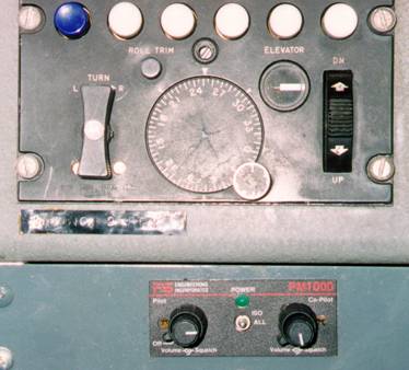

Tommy,
You didn't say which old Bendix A/P you have -- is it an M4 series?
If so, make sure your "TURN" command knob is in the center detent. It's a very subtle detent and if it's out, it cancels HDG mode or NAV mode.
See the "TURN" knob below.
Next, check your ROLL trim. On some A/P control heads, if this is pulled out, it can cancel or interfere with HDG mode. This also has a detent, so see if you can find it and start engaging HDG or NAV mode from that point.
If either of those checks don't get you0happy, take the airplane to Autopilots Central in Tulsa, OK. That may be far away from you, but I don't know of anyone left who understands0the Bendix/Motorola M4s.
There are some trim pots than can be adjusted for ROLL or NAV track and that's best done in flight with the autopilot technician turning set screws while you keep the airplane safe.
It may be that you need a circuit board replaced. Autopilot Central should have them, or, can trouble shoot components if need be.
It may be that you need the autopilot replaced and I trust if that's so, several TCFG members will check in with their recommendations on modern systems.
