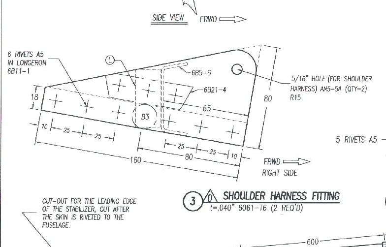

John:
As usual you bring up a very good point. I talked to
Jon Croke at Oshkosh and saw his scars. Thanks for
the post. I'm attaching a portion of a scan from my
601XL drawings showing the 601XL seat belt attachment.
Here is a picture of mine installed since I followed
the drawings while building.
http://www.cooknwithgas.com/3_02_06_ELT.jpg
As you can see in the photo it is not used and I
attached mine further back using AN3 bolts into a 3/4"
thick longeron.
I did this for peace of mind. Thanks again,
Scott Laughlin

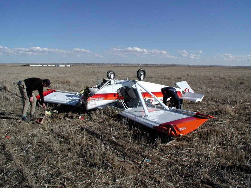

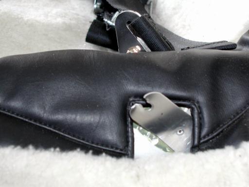

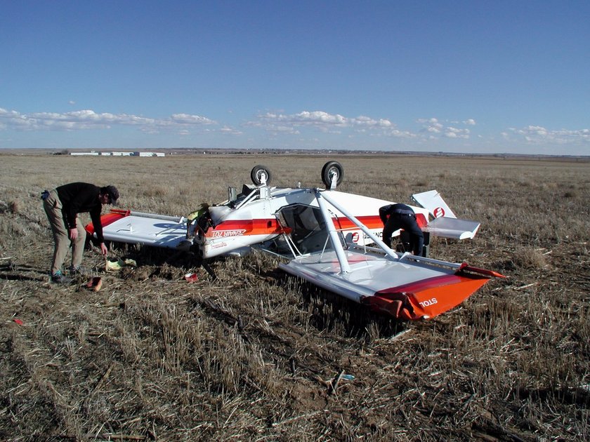

PostPosted: Mon Aug 07, 2006 2:18 am    Post subject: 701 seat belt attach Reply with quote
Here is a picture of the 701 plane crash that Chuck D. refers to........N4386W
And a picture of the seat belt attachment showing it pulled through.
It was not Chuck's or my plane. I believe the plane was in Colorado at the
time
Monty Graves

rwehba(at)cebridge.net
PostPosted: Mon Aug 07, 2006 3:05 am    Post subject: 701 seat belt attach Reply with quote
did it hit a hole and flip??

mgraves(at)usmo.com
PostPosted: Mon Aug 07, 2006 8:11 am    Post subject: 701 seat belt attach Reply with quote
I forget what happened. Its in the archives
Looks more like he tried to land going across the rows instead of with
them. Looks like the nose wheel completely separated from the
aircraft. Then the nose and prop dug in and flipped....... Not sure what
kind of stubble that is, but a sure way to do some serious damage is land
in corn stubble across the rows.......
The plane was painted in Frontier Airline colors. I believe the pilot was
a pilot for them with high time hrs... just not in the 701........
Monty

It seems to be an early design, the belt attachment fitting thickness on early prints is .040.
Current prints call for .063 thickness. Just for info.
entecrj(at)sbcglobal.net
PostPosted: Mon Aug 07, 2006 11:00 am    Post subject: 701 seat belt attach Reply with quote
them. Looks like the nose wheel completely separated from the aircraft.
Then the nose and prop dug in and flipped....... Not sure what kind of
stubble that is, but a sure way to do some serious damage is land in
Monty
Thats wheat stubble in the picture, wheat stubble rows are fairly shallow,
but you can't rule out ruts from combine and grain cart tires.
R. Johnson

PostPosted: Mon Aug 07, 2006 11:18 pm    Post subject: 701 seat belt attach Reply with quote
I am no expert in accidents but have made a couple of search and rescue missions and have talked to local experts a lot. This gives me some hints where to look.
I think this pilot got "get-down-itis" and just pointed to nose to the ground. Maybe he tried or thinked to level for flare when the front wheel was about an inch from the ground.
Look at the wing tips they just smashed to the ground, not a low speed stall, because both wing tips are damaged very similar, The plane was flown to the ground, also the distance where front wheel and the prop hub touched the ground is only a few inches from the nose of the inverted plane.
Good thing that was the old and lighter 701 and (I think) was not going fast (40 mph or less maybe), but he just hit the ground at an angle (?)!. He was lucky to survive (he is commenting the accident, another hint Smile...
Just my point of view, probably completly wrong. Please Do not archive.
