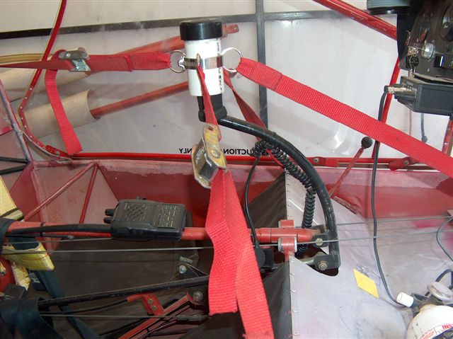

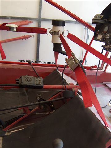

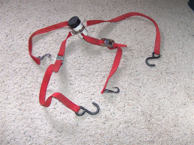

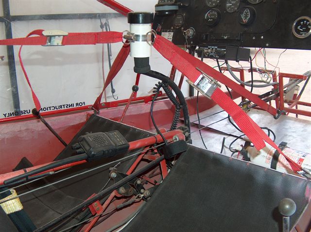

Guys,
Here are some pics of my little invention - "The Spider." Best control lock I've seen yet. When in place and tightened, it feels like the control stick is welded in place. The MV guys liked it and some copied it. Someone modified the design but the modification didn't work as well as the original (heh, heh, heh - sorry, I couldn't resist.) I works a lot better than a seat belt and just takes a minute more to install. If you make one, a key point is to cut a groove in the PVC at each place the rings go, otherwise the rings will tend to flop over. If you make both the fore and aft straps adjustable, then you can set the elevator where you want it, up or down. Mine isn't adjustable so the elevator is locked in neutral. One of these days I'll change forward strap to an adjustable one.
AzDave

Dave --
You should use standard stainless steel plumbers straps and then you
could use this D-Ring Bracket:
http://scubagear.stores.yahoo.net/004136.html
With the D-Ring Bracket, you not only will not "capture" the d-ring
(i.e., it will move freely), but you won't risk hurting the PVC.
I use these in diving all the time.
-- Robert

Dave, that is one heck of a sturdy stick holder. I gotta ask, however, how hard is the adjustments to make while in flight? That is a poor mans auto-pilot, is it not?
Ha, Ha!
Why a man would have to be mighty skinny to fit between some of them belts and adjusting in flight would be scary, but some of you guys can "fly and chew gum" at the same time. I keep biting my lip!
Ralph gotcha right here in Ohio!
Well Ralph, that's why I have the quick-disconnect types of straps. The
first time I flew I had ratchet straps and almost killed myself on landing
because it took two hands to release and was too slow. The type I use now
can be operated with only one hand. Much better.
| Quote: | That is a poor mans auto-pilot, is it not?
Of course. The first time I used it I set it and slept all the way to
Seligman, a distance of 2 1/4 miles.
| Quote: | Why a man would have to be mighty skinny to fit between some of them belts
Hmmm, maybe I should market it as an incentive to lose weight.
AzDave
