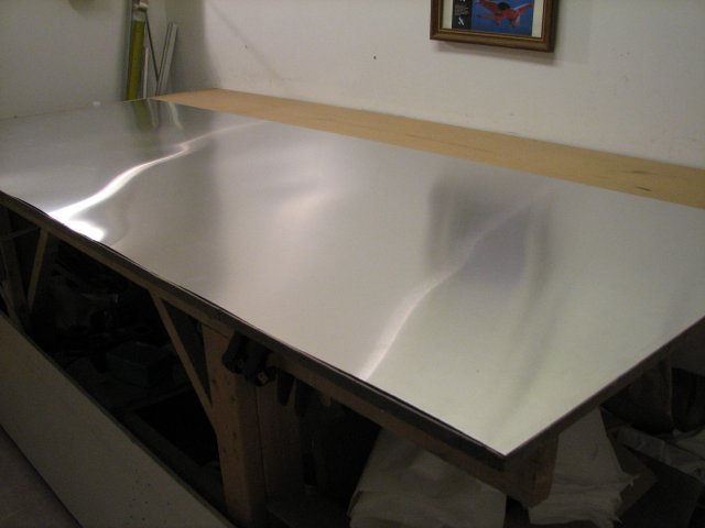

I just finished polishing one of wing skins (rear top, CH601-HD).
The part is about 3' x 8'.
It took me ~1h/sqft, at a cost of CD$1.25 or US$1.10.
Pictures can be seen on the Forum - the URL should be under this msg.
Just click it and you will get there/here (!?!).
(I have never posted on the forum - pictures may be in reverse order.)
The polishing paste is "Mothers", applied with paper towel cut to size.
As the paper gets "loaded" with the black stuff, it is replaced.
Repeat. Repeat. Repeat. Repeat. ...
Happy building...

Hey Carlos, Looks real shiny. Is it ready to rivet or just a flat sheet without holes?
