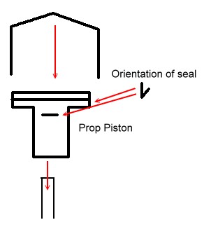

Okay. Thought i was doing something simple but apparently not so.
I replaced the two seals in the prop "piston" and now have some substantial vibration. Here's the scenario:
1. Replaced two seals in piston (see diagram for orientation of the v-shape of the seals). Note: I did not disassemble the blades or change blade angle in any way.
2. Ran the engine and noticed prop vibration.
3. Disassembled prop piston and found oil in the hub. The seals looked fine so I assumed a pinched seal or I dumped it in when i pulled the piston off?
4. Reassembled, ran engine and same vibration.
5. Disassembled prop piston and found no oil in hub.
6. Reassembled, ran engine and same vibration.
The vibration is minimal from 35 to 45%, peaks at 50% and subsides up to 60 and 70%. Mag drops are normal and prop cycles normally at 70%. The vibration at 50% is significant - definately not healthy for any period.
On disassembly there appears to be roughly 16 fluid ounces of oil in the prop piston but, again, none in the hub.
Any ideas? This one has me baffled.
Thanks!

PostPosted: Mon Sep 04, 2006 4:23 am    Post subject: Prop seal replacement and subsequent vibration Reply with quote
Scooter,
First - Is this an M-14 or HS-6?
Second - Are you sure this vibration was not in the engine before? You may be noticing it now that you're 'sensitive' to the fact that you've worked on worked on it for the first time.
If its an M-14 did you leave the prop level while working on it. Moisture in the wood blades can 'flow' to the tip of one blade and the hub of the other, if left vertical.  Maybe this is the vibration you feel.
If there is no oil in the hub than its fairly assured that the seals are working as they should.
If this is M-14 check that all the prop bolts on the prop flange are there - tight and secured.
Also check to see if you may have inadvertently removed any balance weights.
This will be interesting. Good luck

PostPosted: Mon Sep 04, 2006 6:53 am    Post subject: Prop seal replacement and subsequent vibration Reply with quote
Scooter,
Since you say the vibration started after you removed and replaced the seals
in the dome and piston and you said you did nothing else, the only other
possibility which is rather remote is to remove the dome and rotate it 90
degrees and see if that changes anything. I doubt it will, but it won't
hurt to try.
Check to see if you have any "slop" in the counter weight arms. That is,
try moving one side and see if there is any play. Now try the other
counterweight. You may just have a worn hub. BTW, did you try moving the
counterweights fore and aft when you had the dome and piston removed. They
should move with some reasonable restriction. Most importantly, they should
move and you should be able to push/pull on one counterweight and be able to
move both blades.
It is not logical that you have had a hydraulic lock that is causing the
vibration. I have seen several Yak 52's that have the vibration somewhere
between 47% to 53%. As an experiment, try putting a wrap of duct tape on
one of the blades about 1-2" in from the tip. Run the engine and see if it
gets worse or better. If better, add another wrap of duct tape. If worse,
try the same thing on the other blade. Once you determine which blade needs
the weight, you can add weights to that side of the hub or if it requires
very little weight, you can use spray paint on the back side of the blade to
balance the blade.
Make sure all the parts labeled "1" and "2" are all on the same side of the
hub. That includes the blades which have a "1" or "2" stamped in the metal
blade shanks. Even the small locking plates on each side of the front of
the hub are labeled "1" and "2". If you removed the blades by unscrewing
just the blades from the hub, use a digital level or protractor to reset the
blade angles. This is not the same as removing the large castellated nuts
to access the bearings and races.
Finally, find someone to dynamically balance the prop.
Dennis

dsavarese(at)elmore.rr.co
PostPosted: Mon Sep 04, 2006 3:33 pm    Post subject: Prop seal replacement and subsequent vibration Reply with quote
Stuck valve? hummmmm..... I seriously doubt a stuck valve is going to
work properly at 60% and above and not work properly at only 50%.
No oil in the hub means you installed the inner seal correctly. And outer
seal improperly installed will cause the worst oil leak you ever saw when
you run the engine. When you remove the dome and piston, separate the
piston from the dome. Then dump out all the oil from the dome. Now insert
the piston only back on the oil tube and look at the gaps on the top,
bottom, left and right. They should all be pretty close to the same. If
the gaps are way off, the oil tube is bent and should be replaced. You'll
have to remove the prop to remove the oil tube unless you have a VERY deep
well socket.
With oil in the hub dome and piston, is there any play in the counterweight
movement. There shouldn't be any play. If there is, the hub may need to be
overhauled.
Try the duck tape tests I mentioned earlier.
Dennis

Actually the vibration peaks at 50%. It is present from idle to 70% (I haven't pushed it any higher). It ramps up from idle to 50% then ramps down. It's difficult to quantify exactly.
Mag drops at 70% were normal.
I'll try those tests. Any other advice will be greatly appreciated. Keep in mind that everything was absolutely normal prior to removing the dome and piston.
Thanks.
well socket.
overhauled.
Dennis

Thanks. I'm beginning to think that the vibration problem is
coincidental to the seal replacement. The blade angle can be changed by
pulling on the counterweights - the blades move together and I didn't
detect any slop. The prop doesn't have any knicks or missing hardware. If
I run it up to 70% and cycle the prop it goes between 70% and 50% (pretty
much like it always has).
The vibration is pretty significant. It's hard to quantify but it
bounces me around pretty good. I took the piston out yet again today (5th
time?) and didn't find any oil in the hub.
I spoke with a mechanic at the airport who is leaning towards a stuck
valve. He's going to do a compression test on wednesday. A stuck valve
sounds better than a bent rod...
