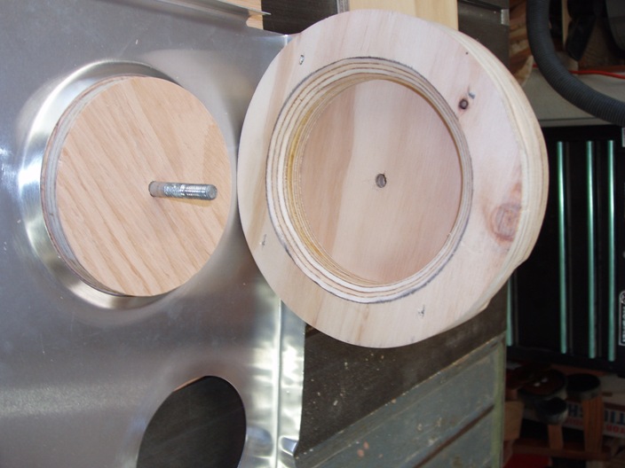

Ever since Bill Naumuk convinced me that I could scrap build my center section and fuselage (after kit building the tail and wings), I have been known to stare at the ceiling in the middle of the night, visualizing how I could build flanging dies out of wood.
Not to be outdone by Dave’s Cheap Sheet Metal Bending Brake, and in an obvious effort to take the food right out of the mouths of the babies of machinists, I finally made, and used (successfully), flanging dies out of plywood!
I hope the attachments are within the abilities of all to download, and, since this is my first attempt at attaching an image, I am currently sitting uncomfortably in my asbestos underwear.
Wood is really what I am most comfortable with. Switching from a Pietenpol to a 601 was a last minute decision after completing the WW Corvair Conversion. Any of you wood-chucks out there, like me, who wish a more detailed account can e-mail me directly. (any body skinned their 601 fuselage with plywood?....just kidding…)

I tried this approach, but found the ply’s delaminated when I tried to use them.

I was able to accomplish all 10 large holes in the nose ribs in approximately 15 minutes. The dies still look good, too. And that was Home Depot plywood! Guess I’ll keep my fingers crossed…

I also used wooden flanging dies similar to your's.
The person who made them available to me made them out
of "Russian plywood". He also made all forming blocs
using that material. It is a very good plywood, but I
have no idea where we can find this.
Using them with a hydraulic press was very efficient.

You're my kind of guy! You could have bought a hydraulic press from Harbor Freight for about $100, but, no, you've got to build one out of wood!

I agree that Russian plywood is really good. It is not the same sort
of low-quality junk plywood available at the Harry Home-owner stores
at all. It is usually at least 7 layers of Birch. You get more
layers as you get thicker plywood. It is also called Nordic Birch
plywood - some of it even comes from countries other than Russia.
I can get it at two different wood stores in Portland, OR. I like
using it for all sorts of stuff around the shop including nice wood
boxes. You can probably find it at higher class hardwood outlets
rather than construction lumber companies.

I'm thinking of using pressure-treated pine. If you have ever worked with this, you know that it is very hard.

Pine is very soft compared to true hardwoods like oak, walnut, and hickory, and you shouldn't need the poison of the PT. I can't see using fragile soft wood like pine or birch unless you are going to whittle it by hand with a pocket knife. Modern power tools don't care if they are cutting hard or soft wood, and the hard wood would be more durable. 'Course I'm in the hardwoods country of the Ozarks where these woods are plentiful. I'll soon be burning a truck load of hardwood scraps to keep warm, free from a local mill, and most would be ideal chunks to cut dies from. There is one advantage to plywood - the cross grain would prevent cracking with the grain. I'd use ply before PT.

Beautiful work on the flanging die. Considering the quality of your wood work I can see only one thing wrong, you should have used hard wood then your die would last a lot longer. Your die looks like western fir and if it is, that's a soft wood.

Of course you are right. This being the “prototype”, and the fact that it worked so well, I’ll make the two smaller ones out of oak. A few weeks ago someone posted that they had used some of that man-made wood decking material with good results. A person can use whatever they want. Mostly, I thought to show the simple ‘jig’ that I used to create the male and female bevels.

Pine and spruce are soft but birch is fairly hard.
Ed Moody II

PostPosted: Sun Sep 03, 2006 10:59 am    Post subject: Gary's Cheap Flanging Dies Reply with quote
Gary,
Nice work. There's been a lot of talk about using a better material. Well here's one more. Consider using masonite or MDF. I made my set of dies from a combination of 3/4" thick fiberboard and 1/4" masonite. These materials provide a few advantages. I did all my flanging with these and they showed no ware and tear. It's hard and there is no grain. Best of all, it's cheap compared to plywood. I bought a 4x8 sheet of the 3/4 fiberboard for under 10 dollars. I made all my form blocks and dies from that sheet, with exception of the form for the firewall that I had already made from plywood.
I looked into these materials when someone on this list suggested using the plastic wood now available for deck materials. I like the idea, but I found that these were very expensive.
Dan

PostPosted: Sun Sep 03, 2006 12:22 pm    Post subject: Gary's Cheap Flanging Dies Reply with quote
I'm not planning to leave the wood in contact with the aluminum for very long. I figure that the short contact time will save me from having to use an acid metal prep. Smile
