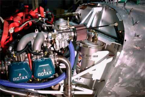

Didn't like cable throttle system,hard to tune carbs.
third 912 I have converted,no problem.
must build all new bell crank system.line up arms with carb levers.
put spring loaded friction on cross tube. Both throttles kept.
Hugh Roberts
[img]cid:002a01c6d122$4c92cc20$92b033d8(at)hppav[/img]

daberti(at)sbcglobal.net Guest
Posted: Tue Sep 05, 2006 2:43 pm Post subject: throttle |
Hugh,
How do you counter the thrust inputs on the engine? I would think with this setup engine thrust equates to carbs out of sync. It doesn't take much of a movement on the linkage arm to pull different vacuum loads form one carb to the other.

hughfr(at)evertek.net Guest
Posted: Wed Sep 06, 2006 7:23 am Post subject: throttle |
Dave,
The throttle settings do change as the engine moves from thrust and roll from torque.
I think if the control rods are parallel in all directions both carbs will change the same amount.
I'm not sure how much they move but I bet it's just a few thousanths due to the 14 inch long throttle rod.
I think the vacuum crossover tube should fix any slight variations.
I use ball rod ends to get rid of any side loads on carb.
Hugh
P.S.
Forgot to mention----912S engine--CH701. Kept cheap T throttles.

Float Flyr
Joined: 19 Jul 2006 Posts: 2704 Location: Campbellton, Newfoundland
Posted: Wed Sep 06, 2006 5:57 pm Post subject: throttle |
The easy way around that, if it bothers you, is to attach the throttle rod to the engine block instead of the fire wall.
Noel [quote]
