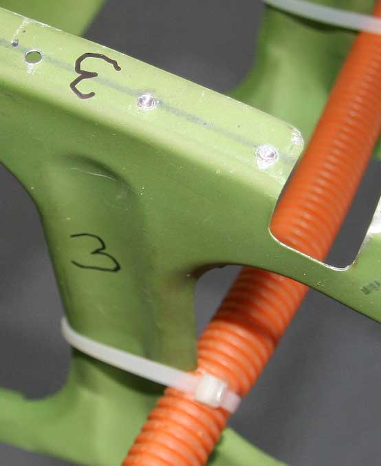

In taking apart one of my wing leading edge skins, I discovered that the plastic tube that protects wires as well as my pitot / static tubes was simply zip-tied to all of the leading edge ribs. As you can see in the uploaded picture, after about 230 hours in my plane, the "protective" tube in mine is a short time away from cutting wires / tubes. About half of the rib-attachments show cuts of this magnitude.
I think someone told me that Moose quick build wings all have their wires / pitot tubes routed (zip-tied) like this. Is that true, or am I just lucky? Seems that there's a lurking problem out there...
Ted Waltman

Interesting. I'd not have thought that the vibration could but through the tube like that. But I reckon it can.
I wonder what would be a prefered method for doing this... pondering... Is there a 90-degree clamp designed for this type of situation, I wonder? Nothing that I saw in the ACS catalog... hmmm... Perhaps glue/epoxy a rubber/nylon edge piece where the conduit meets the metal?

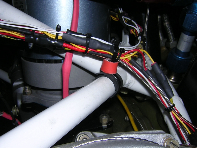

I reckon it would look something like this, now that I've been looking over some other construction photos:
http://tincantimes.dcsol.com/Default6_files/2005_0117_123953AA.jpg
I'll keep this as a mental note for myself when it comes my time Smile

Does it look like there is room to run the conduit down the very leading
edge? Along the front side of the front spare, just inside the curve?
Seems it couldn't move much at all in there and you wouldn't have to put in
a zillion clamps, however not sure how much room to get wires around the
forward attach fitting. Maybe jog it back to the other side just before
getting there.
Of course my FB fuselage is just like yours so if the lights stop working
I'll know where to look <grin>.

Sorry folks...forgot to insert the picture of the conduit in my post yesterday. Thanks for reminding me Scott.
I'll try inserting the picture in this email.
Ted

Ted, are any of the “looser” ones doing this? Just wondering if it is okay if they hadn’t pulled the wrap tie so tight?
Another way is to use a short piece of rubber hose as a stand off and still use the wrap tie. Wrap tie goes around whatever through the hose and then around the other whatever. I have a bunch of stand offs like that in my engine compartment and it works great.
Scott

Yes, it it just the ribs with the tighter zip-ties that exhibit the problem. Of course, there's no way to know what's loose or tight if one didn't see inside their wing before it was closed up.
I like your simple approach for the stand-offs.
