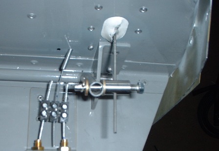

I'm scratching my head trying to figure out how to substitute a conventional throttle with a throttle cable for the T-Handle throttle supplied with my kit. I figured it would be easier to operate and keep the RPM at a cruise setting compared to the T-Handle.
My problem is how to connect it to the Bellcrank. There has to be a way, but so far I've not figured it out yet. The throttle cable is an ACS model with a friction lock. The cable is about between 1/16- 1/8 diameter. Surely there is a device somewhere out there that will work.

This is from our friend from Iceland, Johan, who has finished his very nice
701... without his permission I include:
(sorry for small size picture... I am restricted to dialup out in these
woods that I live...! ) (not complaining, tho!)
Any ideas?

Tommy, I converted mine to the ACS throttle as well. It was actually quite
easy. I made a part from aluminum stock on a lathe to adapt the wire to
the bell crank.
I'm not the originator of the idea however, Johann in Iceland is. Have a
look on his 701 website for pictures of the adaptor here:
http://www.gi.is/fis/zenithpanel.htm

PostPosted: Tue Sep 05, 2006 10:12 am    Post subject: Throttle Cable for Rotax Reply with quote
Great idea from Johan,
My comment, I will just add a little drop of Locktite to the bolt tread... Will not hurt and will prevent loose from vibration.
Saludos
Gary Gower
Flying from Chapala, Mexico.

Hello Tommy.
I used the Vernier throttle from ACS wit the solid wire end, A820 on both sides. I started with the throttle on the left side, and then decided to install it on both sides, because it was the perfect setup.
The old T from Zenith is still on the right side in the picture on my home page.
Did not like that long stick because it was hard to control.
If you need the part to attatch the cable to the steel rod, I could send it to you. Just contact me off list with your address, and I will ship it to you.
