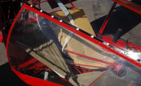

While waiting out an effort by an A&P to repair flap lever this afternoon, saw a spray can of Plexus on a shelf in his hangar. He didn't know if it was any good...got it with a C-150 he bought.
I used it on the MkIII, sprayed on, wiped off, buffed with a clean t-shirt, and it worked better than anything I have tried. Haven't found Novus Plastic cleaner& shine, Micromesh, 3M plastic polish,C-CICE, V&PM Naptha, or Harley Davidson Cleaner/Polish; all recommended to me by you helpful folks out there, in this small NM town.
The difference in the Plexus-treated window at top and the untreated "DeLorean" right door is amazing.
Now to find the stuff! No, I don't work for them. Now if I can't get the flap lever repaired, will get to see if I can see in early morning sun.
jsf

Posted: Thu Sep 07, 2006 2:10 am Post subject: Micro-Surface finishing products |
John
You can find Plexus at most motercycle shops. The stuff works great.
Bryan Dever

Posted: Thu Sep 07, 2006 5:06 pm Post subject: Micro-Surface finishing products |
Hi John and Gang
I have been using Plexus for 3 years, I buy it when I attend the Air Venture in Oshkosh, it works great. I used to use Pledge "No Smear" brand but they took it off the market and it worked really well, the Plexus is comparable; neither product actually removes scratches, but otherwise the Plexus is a great product.
Bill Vincent
