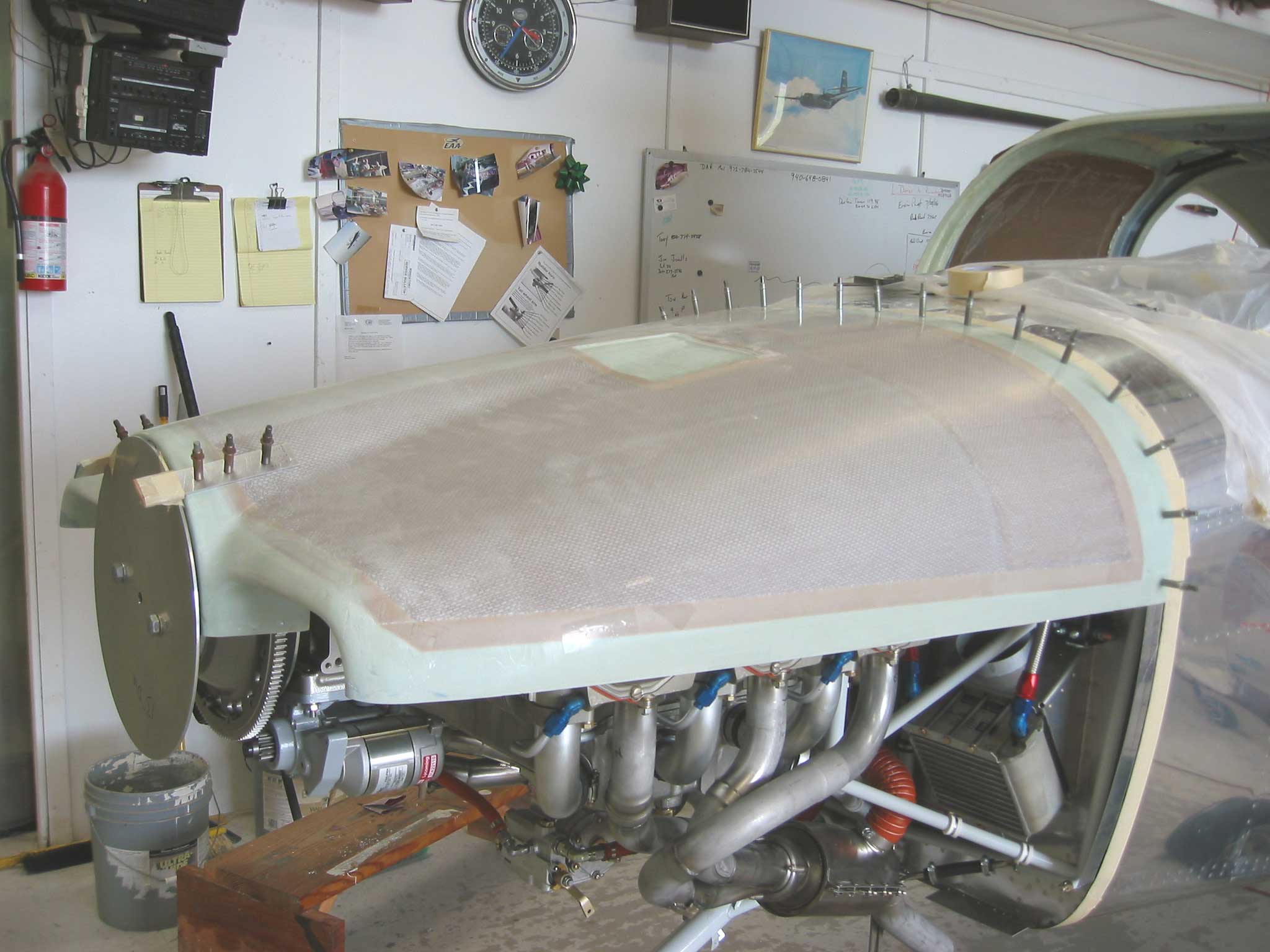

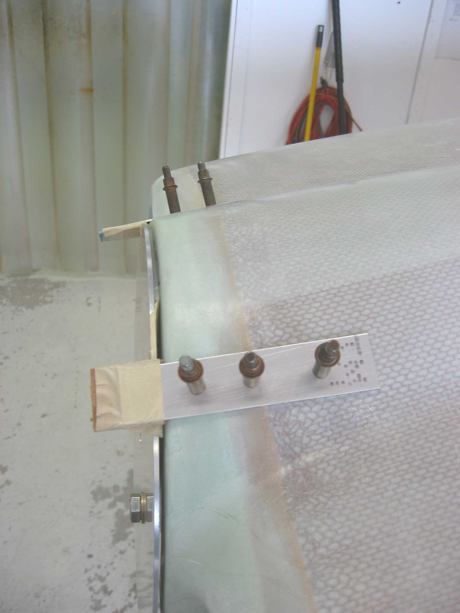

I will have the Aero Composite three blade but I'm guessing that would be about the same as the MT for mounting purposes? We used a 1/8" spacer. I also don't have my propeller yet but Aero Composite sent me a mount plate to use so I can fit the cowling. Maybe MT can furnish you one also?
I was just working on it yesterday and the top cowling went on fairly quickly, I had help.
I've attached a few photo's for you to see what we've done thus far. I'm installing cam locks and will have them spaced at around 3".
