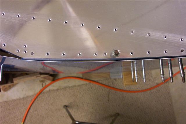

ceengland(at)bellsouth.ne Guest
Posted: Tue Sep 12, 2006 5:39 pm Post subject: RV-7 F-770 forward side skin 'pucker factor' question |
Don,
I added your email address, just in case the images don't make it to the
list.
1192 is rt side. Corner is rolled & clecoed, 623 is unmodified, side
skin clecoed to all 3 bulkheads & bottom skins clecoed to each other,
baggage area horizontal & vertical stiffeners clecoed into the side skin
(vertical stiffener installation removed about 1/2 the pucker, but still
unacceptable; riveting must start at rear spar, pushing excess to the
roll transition, creating high stress at the #30 hole intended to be the
stress reliever.)
1193 is left side. Corner is unrolled, 623 has had flange rebent
slightly in an attempt to fill the gap, side skin clecoed to all 3
bulkheads & bottom skins clecoed together, no horizontal or vertical
stiffeners installed.
Just out of curiosity: when you tucked the roll inside the bottom skin,
did your 'pucker' get better or worse?
Charlie

side skins abut the bottom skin and the 623 flange snugly? When I put it
all together, it looks like my pics, partially riveted. I didn't have to
force anything uncomfortably... Now seeing a hole\gap at the intersection
seemed initially un-vans-like, but I reasoned this as sensible because of
the nature of the transition from the boxy part of the fuselage to the curvy
aft section. And, as you said, the flap has a built-in gap seal with the
fuse.
Anyway, it's pretty nice to know there are a couple other people so close to
where I'm at in construction.
