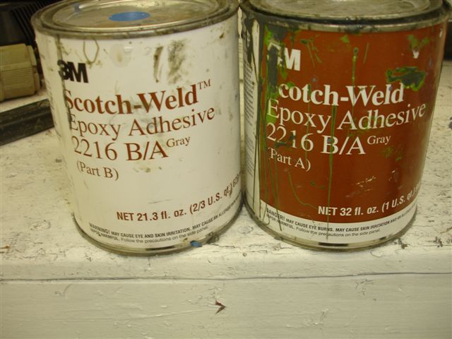

Use this stuff. After it cures, it stays flexible somewhat. Kitfox uses this stuff to bond the ribs onto the spar. I use it to bond my skins to the ribs (and then rivet them the next day). Several of my friends have bonded their RV8 canopy's to the frame with this product. I will use it to bond my windows on my RV10. May be better than Sikaflex. Don't know for sure because I have never used Sikaflex. Picture below.
You can get it at MSC.
Zack

FYI: Attached is the info sheet from 3M on the Scotch-Weld 2216 mentioned
below.
