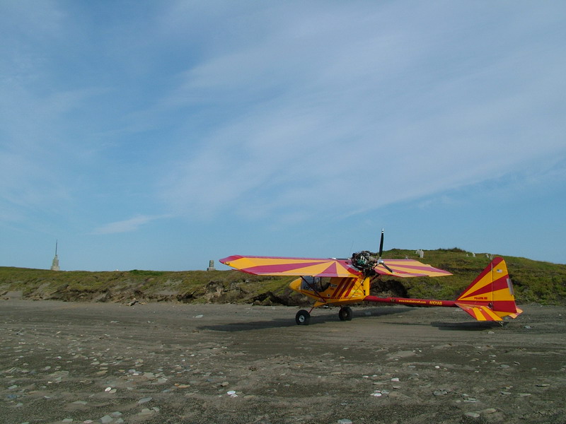

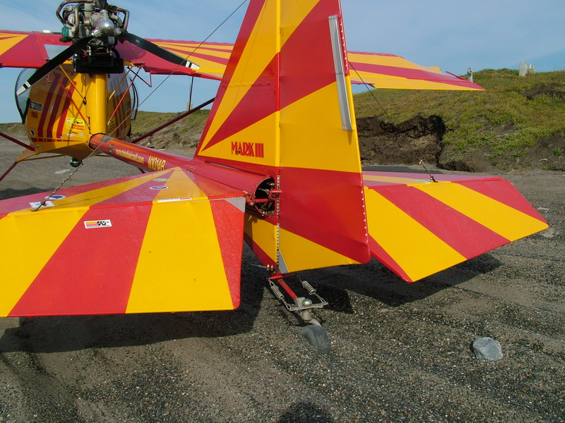

Joined: 09 Jan 2006 Posts: 4639 Location: Titus, Alabama (hauck's holler)
Posted: Mon Jan 23, 2006 9:01 am Post subject: Re: take off with flaps |
| Quote: | | I immagine you used that technique on the the soft beach in alaska |
Morning Mike B/Gang:
That is correct. That was the old Maule 6" solid rubber tailwheel in that picture. In sand, as dry and soft as it was on the beach, 12 miles south of Barrow Airport, the tailwheel acted like an anchor.
Poor planning got me on the beach with full fuel and gear, aprx'ly 1,200 lbs takeoff weight. I should have gone down the Will Rogers/Wiley Post Memorial before I refueled after my flight from Helmericks. Would have been easier to get in and out of the beach. However, the old fat MKIII did her job quite well, as usual.
I now have an 8" pnuematic Maule Tundra Tailwheel which would have done a much better job.
I have attached two photos of Miss P'fer (P fer plane) on the beach on the Arctic Ocean at the Will Rogers/Wiley Post crash site and memorial. Very solem feeling standing alone on that beach where these two adventurers died in 1935.
Little MKIII never ceases to amaze me.
