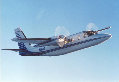

Geared, Supercharged & Fuel Injected:
680F; 680F(P); 680FL; 680FLP; 685.
Barry not to be a nitpicker but the 520Ks are turbocharged not supercharged and they are also intercooled. Smile
To expand upon Wing Commander Gordon's comment about the 520Ks consuming 3 jugs a year I think a more accurate measure would be 3 cylinders per engine for every 700-900 hrs flown.
These beasts are putting out 435HP each on only 520CID (.84HP/CI)
Thats a lot to ask from an aircooled engine running overboost especially when 870HP total is really inadequate for that particular airframe.
With graphic engine analyzers and judicious lean of peak ops you can extend the life a little and only consume 2 jugs each 900 hrs+-. This costs a bit at the top end in performance and saves about 3GPH per side.
Good grief I go away for a few years and Ya'll forget everything I taught you. Rolling Eyes
OVER HIO at the flyin
