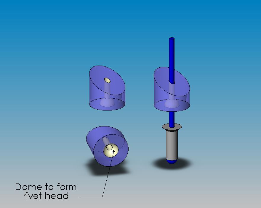

Posted: Mon Sep 25, 2006 9:01 am Post subject: Re: Riveting oneself into a corner |
I just felt like drawing something. See the attached photo (30KB).
Dino Bortolin

| dpfisher(at)scottsbluff.n wrote: | Hi Tommy,
Try grinding the dimpled face of your nose piece at a 15 degree angle and
then redimple it, or you can accomplish the same thing by making a
separate angled and dimpled attachment to slip over the rivet stem before
you pull it. You can then angle the riveter into the corner while the
crooked nose piece gives you a flush set on the rivet. The rivet stem will
be pulled at an angle but you'll get a straight set on the rivet.

Tommy Walker
Joined: 12 Jan 2006 Posts: 442 Location: Anniston, AL 36207
Posted: Tue Sep 26, 2006 4:01 am Post subject: Riveting oneself into a corner |
--> Zenith-List message posted by: "dbortol" <dbortol(at)gmail.com (dbortol(at)gmail.com)>
Dino Bortolin
La Salle, Ontario
XL/Corvair
Very neat Dino. I wish I had the equipment to turn that drawing into a steel nose piece. My file and hand drill made one, but not anything that looked as good as your drawing.
Tommy Walker in Alabama

paulrod36(at)msn.com Guest
Posted: Wed Sep 27, 2006 7:51 am Post subject: Riveting oneself into a corner |
<?xml:namespace prefix="v" /><?xml:namespace prefix="o" /><![endif]--> Hey guys, there's an easier way than having to work up a nosepiece to fit your job. Several years ago somebody on this list came up with an easy way: As I recall, it went like this: 1: Using the appropriate size bit, drill a hole lengthwise into a chunk of bolt or round bar. 2: Cut the bolt or bar to an appropriate length, on a slant that will give you room for the riveter. Cup the slanted end as with the nosepiece. 3: Slip the mandrel through your "new nosepiece", and into the riveter, putting a slight bend in the mandrel. You then get a pull perpendicular to the work, with your riveter on a slant. I had several rivets that I needed to do this, and it worked.
Paul Rodriguez
601XL/Corvair
Still on the canopy

601zv(at)ritternet.com Guest
Posted: Wed Sep 27, 2006 1:05 pm Post subject: Riveting oneself into a corner |
Isn't that a description of what Dino so nicely drew, or am I missing something?
Posted: Fri Sep 29, 2006 1:08 pm Post subject: Riveting oneself into a corner |
<?xml:namespace prefix="v" /><?xml:namespace prefix="o" /><![endif]--> Dunno. Didn't look. Probably his one picture is worth my thousand words.
