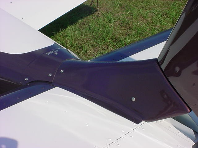

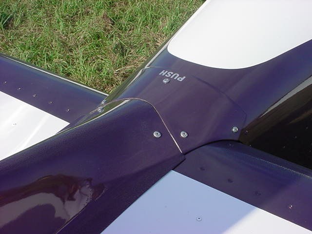

I've wondered, too, about mounting the stab after the top rear skin has been riveted. The mod in the pictures looks pretty slick.
A really neat solution would be for Zenith to redesign the fiberglass piece that fits on top of the stab under the leading edge of the rudder. Is there any reason why it couldn't extend all the way up to the rear bulkhead?

By notching the top fuse skin, the horizontal stab can be installed later.
As shown in the attached photo, make a cardboard template before cutting
metal.
R. Johnson
601-HDS / Corvair
(putting the engine together)
