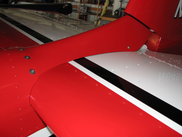

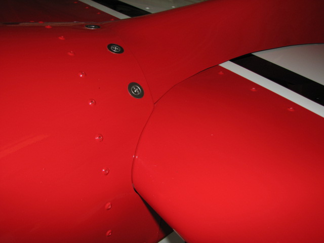

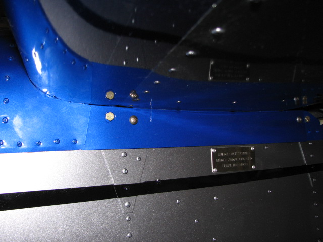

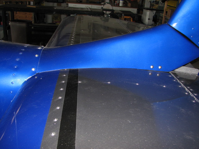

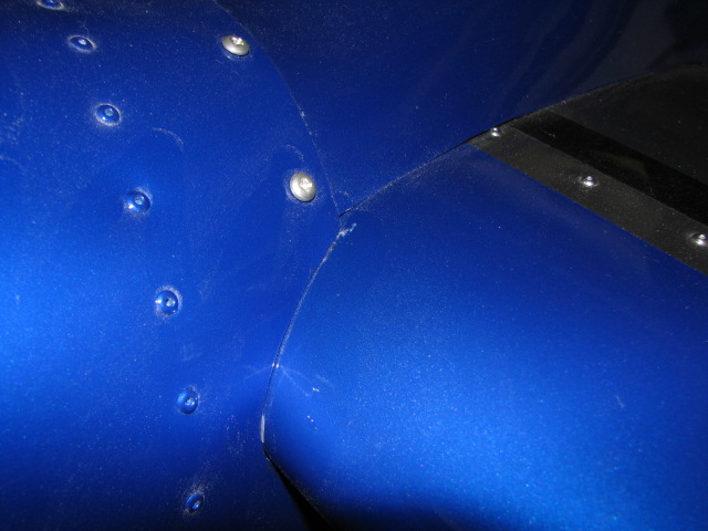

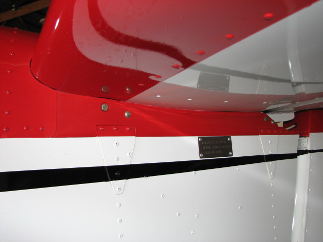

A week back there were many posts about fitting the Stb. with the rear skin in place. Some said it could be done and others said no way. I wrote in about my HDS and a friends HD and said both Stabs. could be put on with the rear skin on. Both were build just like the plans said. Tape was put on the rear skin inside the cut-out to keep the paint from scratching. The Stab. was slid in place at a slight up-right angle and then lowered in place. It takes two people and a little bit of care. I said when I get out to the airport I would take some pictures of our planes. (See attached pics.)
