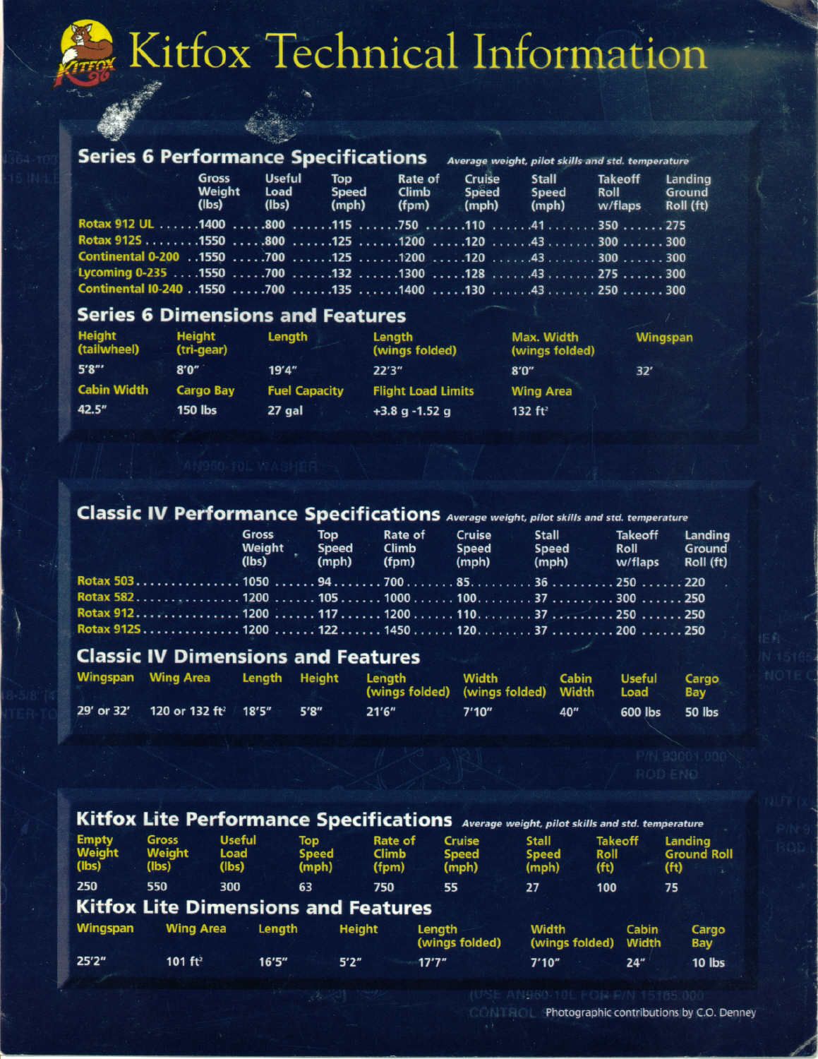

PostPosted: Sun Oct 15, 2006 7:50 pm    Post subject: Model V with O-200; questions Reply with quote
Francisco;
Interesting specs. Much like what my friend is experiencing. Here is a copy of the specs sheet page for a model 6 Kitfox (along with the IV on the lower part of the page).
I wonder if a different prop, say one from a 150 Cessna would improve the performance? Have you ever tried a different prop on your Vixen?
Paul

Fox5flyer
PostPosted: Mon Oct 16, 2006 3:01 am    Post subject: Model V with O-200; questions Reply with quote
I can't speak for the factory specs and I tend to agree with what you say in that they tend to embellish them. That being said, your reported cruise/climb speeds for the 0200 are definitely low. Something is seriously wrong there, but then again, drag reduction is a pretty big factor, especially with the struts. That doesn't explain the poor climb rate though. Possibly the engine isn't producing rated power?

PostPosted: Mon Oct 16, 2006 6:58 am    Post subject: Model V with O-200; questions Reply with quote
Paul
I have never tried a different prop. May be would be better another prop like a Sensenich
Francisco

Francisco;
Paul
